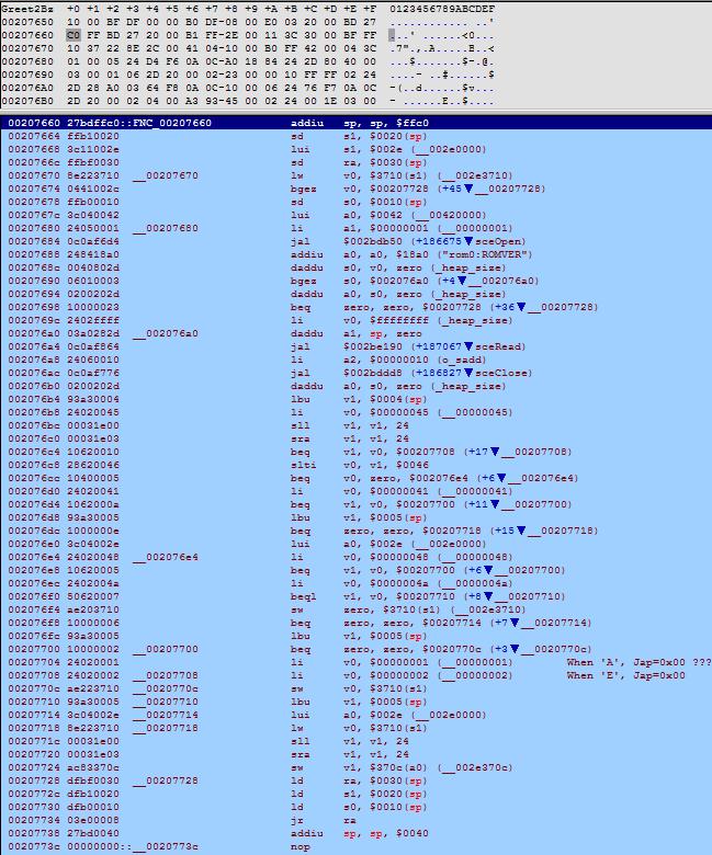

    Tested on my SCPH-39004 console :
    0x00 = PAL 60 Hz / Multi2 (Might be Jap LNG)
    0x01 = PAL 60 Hz / Multi7 (Might be US LNG)
    0x02 = PAL 50 Hz / Multi7 (Might be Euro LNG)
    0x03 = PAL 60 Hz / Crashes When Accessed (Not in BIOS ? Out-of-bounds ?)
    0x04 = PAL 60 Hz / Crashes When Accessed (Not in BIOS ? Out-of-bounds ?)
    0x05 = PAL 60 Hz / Crashes When Accessed (Not in BIOS ? Out-of-bounds ?)
    0x06 = PAL 60 Hz / Crashes When Accessed (Not in BIOS ? Out-of-bounds ?)
    0x07 = PAL 60 Hz / Crashes When Accessed (Not in BIOS ? Out-of-bounds ?)
    So that function changes the language selector with its associated refresh rate, but not the colour encoding system.

    The only 4 returned values for that function are 0, 1, 2 and -1. -1 is returned if the console is out of the supported regions ('E', 'A', 'H' or 'J'). 0 is for (Japan) NTSC, 1 is for "Overseas" NTSC and 2 is for PAL.
    I believe that your TV might be seeing a NTSC signal with the PAL resolution (Hence why you get PAL60), as OSD itself is confused. There is no PAL60 mode in the Playstation 2 boot ROM.
    Perhaps the video mode is determined by other means...
    I don't know whether you know this, but the video mode is set with a call to the SetGsCrt() syscall. The resolution is set separately by the GS library.
    So far, the common video modes used by Sony software with SetGsSet() are: 0x02 (NTSC), 0x03 (PAL) and 0x50 (480P). Mode 0 seems to be a "Autodetect" mode, where it'll cause the PS2 to use NTSC if it's a NTSC console, and PAL if it's a PAL console. I don't know what mode 1 is, but it may be the same as mode 0 (It is, however, not implemented in the Protokernel boot rom, so please do not use it if you want compatibility with all models!).

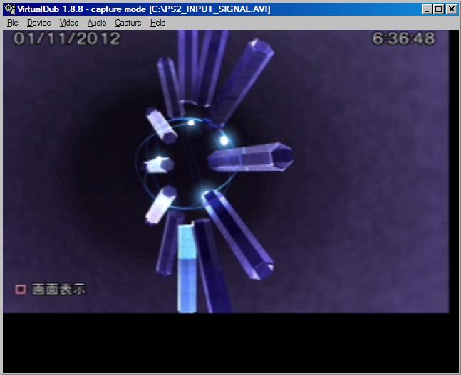

    I've re-coded some parts of my brute force tool. It has found the corruption point for the ROMVER function, but messing up with these bytes leads to a wide demolition of the unpacked ELF:dejection:. I assume that Multi2 fix can't be applied straight to the KELF, unlike my ATAD patches :( . Doh:moody:.
  6. krHACKen
    krHACKen Enthusiastic Member
    Oct 24, 2012
    570
    373
    SetGsCrt took care of both mode and scanrate. By forcing 0x03 (PAL) like you mentioned, I had "true" PAL 50 Hz:encouragement:. I guess I have to tweak sceGsPutDispEnv to correct the screen position and stretch the picture.
    (decrypted ELF launched by a loader)
    I retried patching the original hosdsys KELF with no luck :( . If I build a patch, it will be for the decrypted ELF and perhaps for the KELF that comes out of SUDC2...

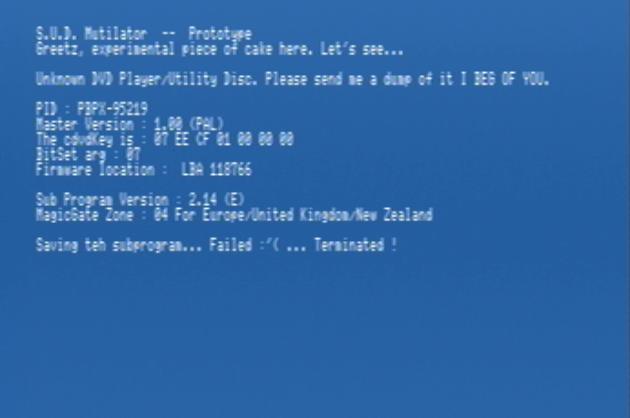

    I already made such a tool, for my personal use, to determine the cdvdKey and positions of wobbles from disc dumps.
    It's a scanner that complies to the following rules :
    Fourth byte of the sector is always 0x00;
    Third byte of the sector is never 0x00 or 0xFF;
    First byte of the sector is always a multiple of 2;
    Wobbles are never located within sectors referenced by the TOC (not in a file);
    Wobble/sector start is never duplicated on the rest of the dump.
    What I'm trying to do now is to add decryption functionalities.
    Decryption is performed in 3 steps :
    1) Unscrambling with a DecSet Write command, and the BitSet (part of the cdvdKey) as argument + cdRead. Fully implemented. The PCSX2 src helped me a lot (mechaDecryptBytes fnc on cdvd.c).
    2) BitWise against a few bytes of the unscrambled data. The algo differs from one Utility Disc to another, although I think there are only 2. The algo for PBPX-95201 (UD v1.00) is implemented. I didn't mutilate your PBPX-95202 yet but I'm sure it is the same thing. So my BitWise function lacks the newer DVD Player upgrade disc algo.
    3) MagicGate decryption. Implemented...
    Once these 3 steps are fully implemented in both CoDec directions, maybe I'll go deeper and put a firmware package unpacker (DVD Player files are packed in one file with a TOC and compressed)... and why not, an automated function to patch things like DVDV zones routines.
    The harder too. If I succeed at making my unscrambler proggy, I'll send you the source code and maybe make it public (less the MG decryption feature of course).
    I may also have to publish a complete documentation about how Utility Discs work, so people can kill the infamous sceReadKey shit and force the sub-program to report a static cdvdKey (for the wobble to be read at the correct sector location).
    Not to give false hope. I quickly run out of time as I jump from projects to derivative projects anarchically. Most of my projects started out as hypothetical ideas and none have been planned or timed.
    EDIT : Oh, I'll for sure send you my collection of descrambled/decrypted/unpacked wobbles in a PM when I find the time, but here's a LBA table that might interest y'all haxors around :
    http://pastie.org/pastes/5349481/text?key=xtuvnt2cathc9jjdvosscg

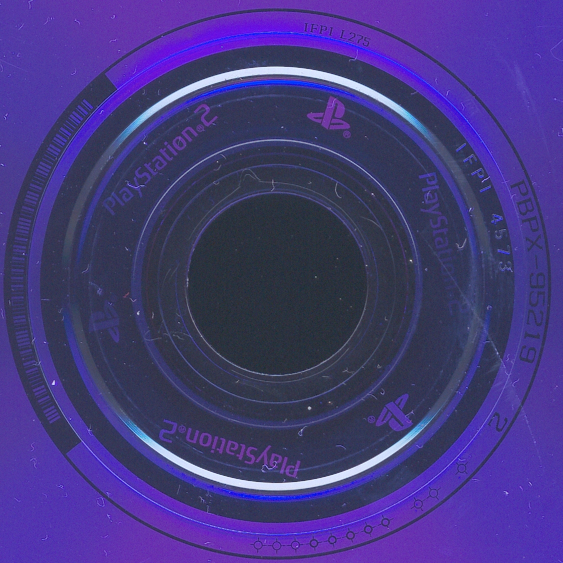

    A contributor sent me his dump of the MC based DVD Player 2.01J. And surprisingly, the firmware does not match the one that has been previously provided by another dumper. Why the hell ?
    Previous dump :
    dvdplayer.elf :
    Size = 591 072 bytes
    Nbr of MG blocks = 33
