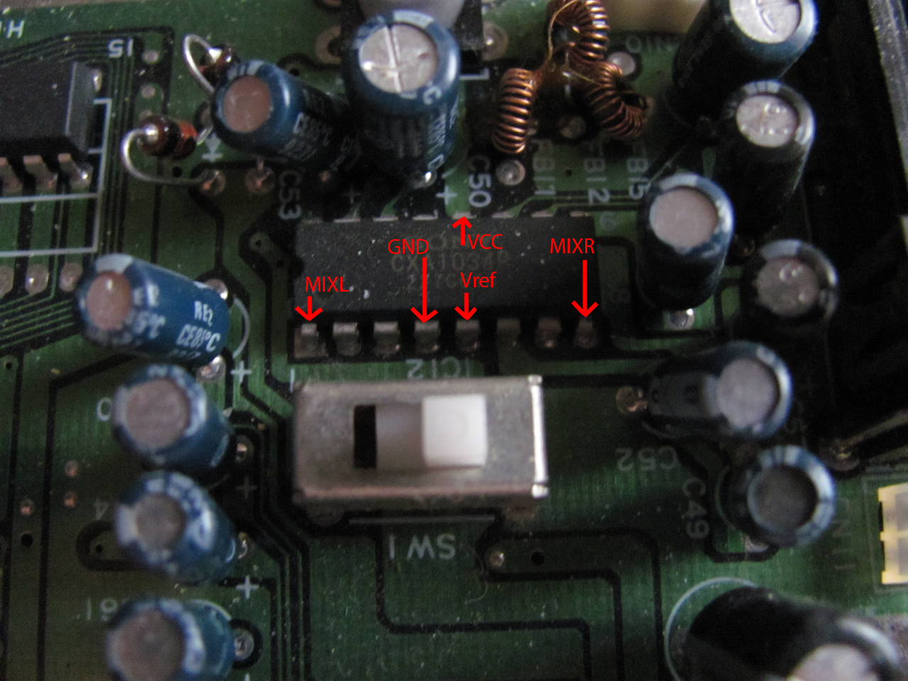

    I have a VA0 Mega Drive (model 1), the volume of the preamp is rather high on these early consoles and the sound from the headphone jack is fairly distorted due to the fact that it's going through an iffy headphone amp after being preamped quite loud. Pulling audio directly from the preamp chip is said to be much better quality than from the headphone jack, but you would need to mod the jacks somewhere onto the case (or dangle them out). I don't know about pulling audio even earlier than the preamp, I am not sure where the YM2612 (Genesis) and the PSG (Master System) sound gets mixed.

    The purpose of the mixer cable is bring the audio from the Mega Drive back into the CD board amplifiers so it can be mixed locally and then pumped out through the "CINCH" (RCA) jacks on the back of the CD unit. When they designed the CD units, they took two of the unused connector pins on the expansion port and decided to use them as output pins from the Mega Drive sound. As MD1 units were already out and could not be modded to achieve that, they could only implement that on MD2s. Hence why the CD unit shipped with the mixing cable.
    Regarding the headphones amplifier, it's designed to be the core IC for stereo portable compact cassette players and being designed to drive a stereo magnetic tape playback head it is a high gain amplifier. Therefore, it adds a background of white noise to the sound it amplifies from the MD circuitry. It's a very good amp but it's on the wrong place... lol

    After taking a look at this schematic for the MD1, it looks like there's nowhere I can tap that has the YM2612(MOL,MOR), PSG, and 32X(SL1,SR1) audio mixed without the CD(SL2,SR2) audio being mixed in as well. On the model 2, the signal is sent to the CD(SL3,SR3) before the CD audio gets mixed in. If I send it with it already mixed in, it will probably be trouble.
    But, I can prevent the CD sending the SL2 and SR2 signals if I leave the mixer plug occupied, so I will probably give it a try and see what happens.
