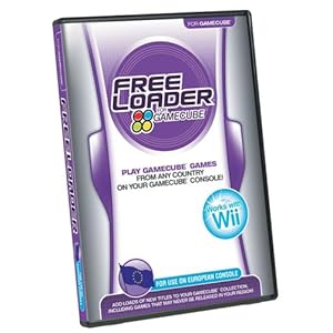

    I'm in the UK and recently got a Panny Q. It plays NTSC US games (some came with it) but i'm after an US format Freeloader disc to allow me to play my native PAL games on it.
    I'm not looking to open her up at all so no modding etc. I bought a Freeloader disc (also compatible with wii it says on the box) but it was region specific and only boots on PAL units - I didn't realise they were region specific beforehand.

    You got the newer version (which seems to be region-locked)?
    I'm pretty sure that the old (original) version would work though...
    Make sure to look for PAL games which have the 60 Hz option, because your only chance of displaying 50 Hz on the Q in color is having a modified custom RGB-scart cable!

    This version is your best bet:
    The older versions are region free, and this one works wonders with Panasonic Q, this is the one I use for my NTSC-US Gamecube and my NTSC-J Panasonic Q.
    BTW, have you tried playing the PAL games directly? It's strange it already plays NTSC-US games by default, it might already be modchipped.

    Thanks for you reply. Mine looks like its been modded as it plays my PAL DVDs as well as US games (it came with all the Resident Evils in NTSC (US) and Metal Gear Twin Snakes NTSC) but it said unknown disc when i put one of my PAL games in.
    As you've pointed out, i bought the freeloader (1st pic) which is compatible with wii but this is for a PAL unit to play other regions - not the other way round. It seems the original freeloaders are getting rare(r). I'll keep my eyes peeled on fleebay for a copy.

    Just for reference, I bought a new Gamecube and Wii compatible Freeloader (like my first PAL one as pictured in the first pic but a US version). As you've mentioned, it works but with a course Black and White pic. Would a 'digital' port component make any difference, does anyone know?
