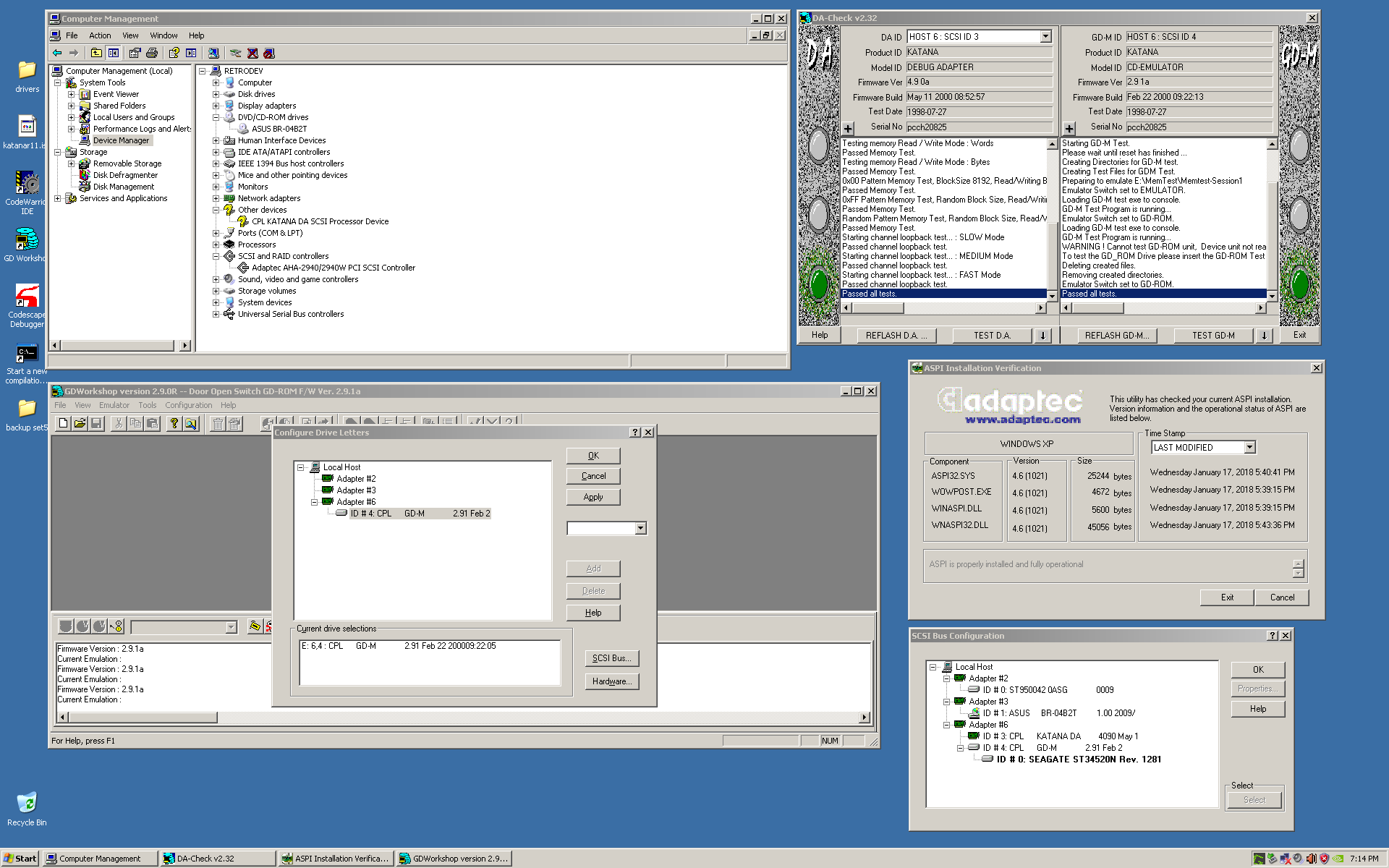

    I set GD Workshop in Emulation as claimed in the doc. but it's not working :s I noticed that the GD-M doesn't appear in the Devices Management , and i can not configure a drive letter in GD Workshop ... I've installed ASPI , and i the DA Check for DA and GD-Rom are all green. Any clues ??
    here's a summary of the setup [​IMG]
    thanks in advance

    Fantastic ! :)
    As long as DACheck is all green, everything should be ok with the devkit for debugging.
    Codescape:
    - what kind of error do you get ?
    - try to put a game in the disc tray, I'm not sure for QckTest2, but some examples in the SDK need a disc inserted, otherwise it exits immediately. (Pretty stupid for a SDK, but understandable to have this kind of check for the retail game, so kind of logic they put that in the SDK too...)
    - try to compile another sample with CodeWarrior or another compiler, and try to debug that via CodeWarrior or Codescape
    Codescape & CodeWarrior takes some getting used to, so play a lot with it.
    Have fun :)
