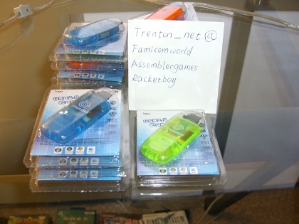

    I haven't seen one in person, but that's mainly because I never needed one. I've spoken with XCKDIY personally, but that was only for DC SD card related business (I previously sold his DC SD card readers, ensuring that I could sell cheaper than everyone else - Including DC-SD.com):
    But outside of that, I never really asked him about his modded consoles. I've seen images of his work, but shipping kills the deal for most everyone outside the few hardcore of collectors/fans.
