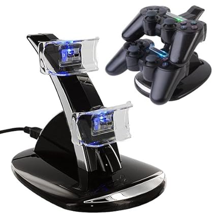

    That is similar to what I am using now, however I want to do this as a neat little project anywhoo :)
    I might pop a current meter on the output of the psu
