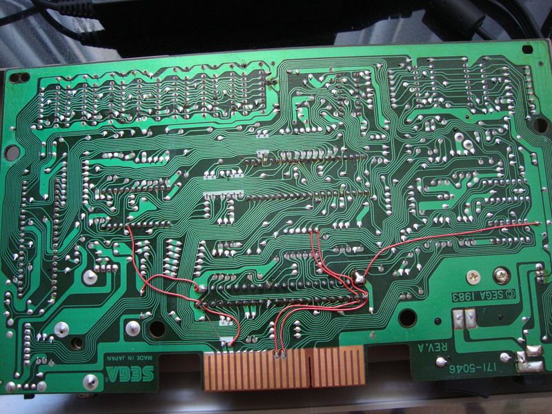

    Well I reflow all the solders of the chips and still the same, I also do what you recommend of putting some pressure on the chips and nothing except when I touch the tms9918 it was hot, not even the cpu was hot like that one and make some color changes but the game never appear or sound changes the buzzing was still there. I put some photos of the board maybe you can see something I don't.

    Thanks oliveira I was thinking about that crystal too. I add a photo I don't know if it can be seen fine but is the only thing it display on the tv. I'll try to take a better photo.
