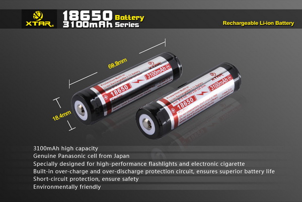

    Please don't make stupid suggestions like that, unless you're wanting people to set their houses on fire.
    There is no charge controller in those cells, and I doubt there's even an over discharge protection circuit.

    Those looked like standard protected li-po packages

    A protected cell still doesn't have a charge circuit built in.

    all the ones I've dealt with do..

    none of them ever do.
    but you're welcome to prove me wrong.
  6. LeHaM
    LeHaM Site Soldier
    May 5, 2013
    2,070
    158
  7. AmmoJammo
    AmmoJammo Spirited Member
    Feb 2, 2014
    181
    ...What you will find, is that you've proven me correct.
    None of those cells have built in charge circuits, they have built in over-discharge/over-charge circuits.
    If you stick more than 4.2volts onto the cell, they will simply disconnect the cell to prevent over charging.
    It isn't a charge control circuit.
  8. LeHaM
    LeHaM Site Soldier
    May 5, 2013
    2,070
    158
    my mistake :)
    I've charged protected cells at 5v no problem before (at a low current), my understanding is that 5v although high, is still within the upper operating voltage limit of the protection IC. It may shorten the life of the board but how would it damage the cell, as there is going to be a voltage drop, until the cell is fully charged then the protection will kick in.
