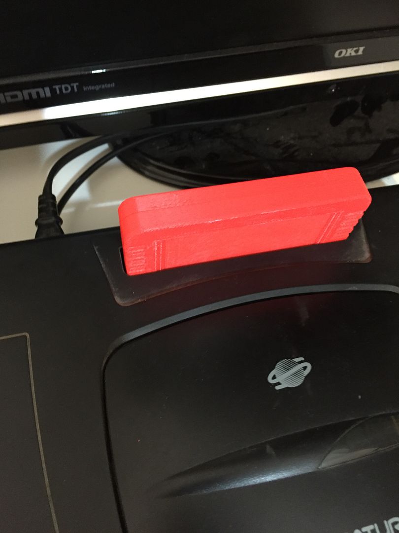

    but today I printed the case hitomi2500 gently shared. I own a commercial 3D printer, so I gave it a go. I have a lot of filament colors, but orange fluo was already installed so... :)
    Printed in ABS, with a heated bed at 100 degrees Celcius and 1.75mm filament. Layer resolution is 0.2mm (highest machine resolution is 0.1mm but would took twice the time). Front case took 2 hours to complete.
    Almost same time (2 more hours) for the back part.
    As you may see below, those 3mm stolen in this PCB design made the left side to be loose. Also, side walls are too long and made the cartridge to not entirely rest flat, so I cut them too. Removed the central hole thing.
    USB mini connector doesn't fit in designed hole. I had to cut like 2mm from the back side to make place for the USB connector.
    Testing the resulting hole with my Microchip Pickit 3 red cable :) (cafe-alpha the cable you sent me is a micro USB instead of a mini USB).
    List of problems with current design:
    - Some design places show errors (didn't fix none of them but could see and fix them using MeshMixer software for example (it's free and very very good));
    - Back part needs a lot of support material. Design should be changed to be 3D printed optimized and reduce printing time;
    - Closing system totally failed. top clips broke very easily. System should be changed for 3D printing;
    - Lip and Groove failed (bad design / tolerance?). They overlapped. Removed;
    - Central hole removed. PCB don't have one;
    Besides all those details, it's a great case design. I really enjoy it.
    Machine time: 4 hours
    Power consumed: about 800W
    Material cost: approx. 60 grams (near 2 USD)
    Maybe I should try printing in PLA instead, but I don't like PLA due to it's very low temperature tolerance.
    Final note: Plastic finish could be improved A LOT by using acetone treatment. I have acetone but I didn't currently use it in this. I may attemp to do it and upload some more images.

    SaturnAR, thanks for the feedback!
    I will see what can be done to fix these problems.
  13. SaturnAR
    SaturnAR Member
    Mar 5, 2015
    Thank YOU for sharing this! I was about to design one from scratch and that would took me a lot of hours. I would love to help fixing those problems, but I'm not sure if I'll know how to deal with that software. I always used SolidWorks for all my 3D designs.
    A video talking and showing some details:
    Thanks!

    Of course, it's not impossible to design a PCB larger than 100 mm width, but it would make PCB manufacturing costs significantly higher, for example, price is doubled on Seeed Studio's PCB fusion service.
    BTW, PCB is not loose when put in official memory cart case.
    This is a problem in my cartridge, not the case : I wasn't aware of central PCB support when I designed this PCB revision (end of 2012), and unfortunately I placed an IC in this "forbidden area".
    Maybe future PCB revision may require this central PCB support to be moved, because it becomes really annoying when trying to route something with a lot of ICs.
    Actually, putting USB port on PCB left/right edge wasn't a good idea, because of the PCB 100 mm width limitation, making USB port hard to reach.
    It would had been smarter to put USB port on PCB top side, because PCB can be resized up to the top of the case without changing PCB manufacturing costs.
    Arg, sorry !
    I test cartridges before shipping them, so I'm confident about them, but cables are sent "new, as-is", without testing.
    I will do a discount for you next time you will want to order something from me ;)
    It's not a hole, it's a PCB support. Latest USB dev cart PCB revision and Wasca should support it.

    Oh, yes. I knew that. I work with PCB design, programming and electronics the entire day :)
    Yes, that central support help cartridge to stay centered and to distribute forces better.
    It would be nice, yeah
    Haha in fact, the other cable I bought and you sent me too, it's a A/B cable but isn't micro either. It's normal size so can't use none of both cables you sent me. But no problem. I have a lot of USB cables, so...
    Yes, sorry. I meant that it is planned for a HOLE being in the PCB.

    Great, that is much more helpful than static pics. Some things you're talking about are already fixed at github (USB hole increased, side support plates are shortened, central pillars are now removable in config, front and back surfaces can be flattened in config, 3mm longitudinal gap removed), some are yet to be fixed (locks etc).
    Oops, i already shifted those holders 1.5mm each to decrease gap. Looks like we need further testing here.
    Not a problem at all. I wanted to add a list of carts in config, so that user will only need to choose its cart, and all the changes will be done automatically. But for now i only added a single devcart from antime's github page, and it's not yet tested enough. Can you give me the list of the carts you're aware of? (with all the versions, they might have differencies) I will add them into config, things will be easier to debug & fix then.
    Actually i copied my design from some chinese 1M RAM cart (which is itself copied from original i suppose, but is more bulky). These pillars were planned not only as PCB support there, but also as a sprue. They don't connect, and there is no hole in PCB. But nobody is stopping us from connecting them, and making a PCB hole in a new-generation cart to increase insertion rigidity.
