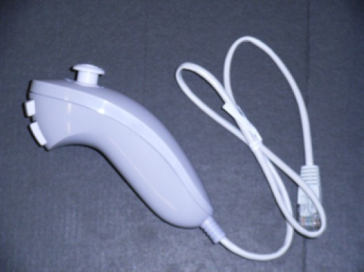

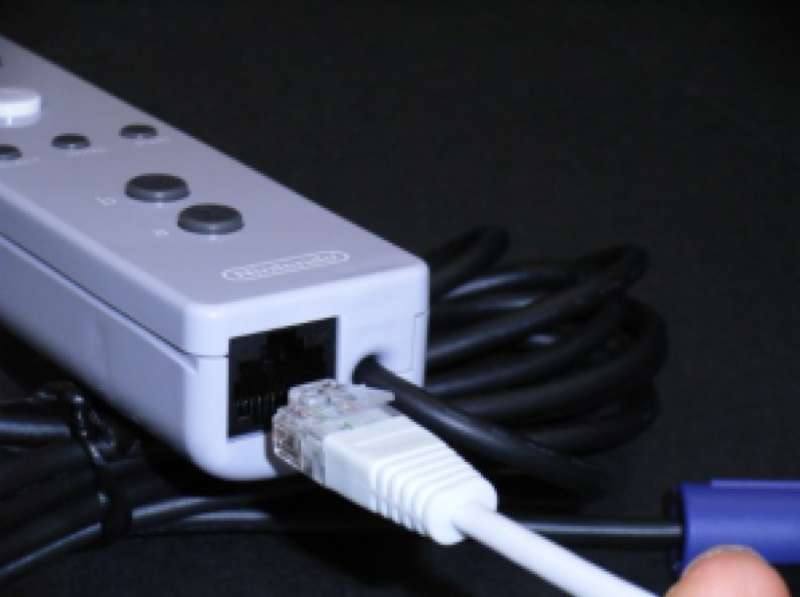

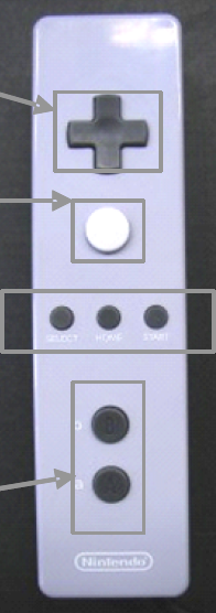

    The Wii Remote is provisionally called a "Game Remote Control", the expansion port has an RJ45 connection and the controller is wired with a GameCube connection.
    The + and - buttons are labeled select and start. The 1 and 2 buttons are labelled a and b.
    The Nunchuk is provisionally called a "Nunchaku Unit" and has an RJ45 connector.

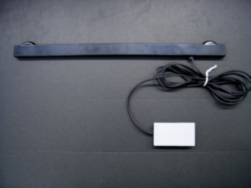

    The Wii Sensor Bar is provisionally called a "TV Marker Unit" and features a GameCube memory card connection.

    So much for "long story short". Anyway, the guy was also selling the matching sensor bar but I was short a few thousand yen and my dad wouldn't lend me any money at the time. Here are some photos I luckily took of both controllers before I had to give them back. Unfortunately I didn't think to take photos of the internals, but I recall the boards looking very professional; they had Nintendo logos and I believe serial numbers as well.
    http://imgur.com/a/MjNun#0
    Note the size difference between it and the retail products (the Wiimote was overall smaller, but the nunchuck was the same length and slightly thinner). I theorised that they were perhaps enlarged to fit bigger hands (aka. the market outside of Japan).

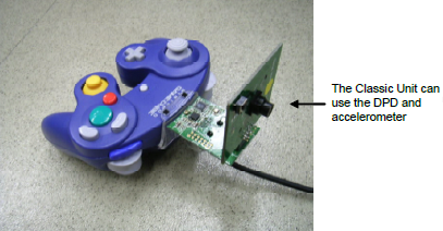

    Other
    They also experimented with attaching an accelerometer and DPD sensor to a GameCube controller.
