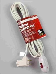

    You could get an extension cord with a switch or a switch cord that reaches the couch and achieve the same effect. Flick it off and on to restart the console.

    That would stop the games from saving by cutting the power wouldn't it?

    Only if you were in the middle of a save.

    The games save when you hit reset, not during a game...
