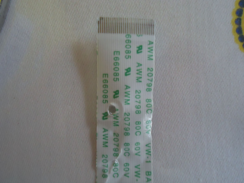

    What you shorted ?
    That don't ask why won't get you ANY HELP. lol
    I in 2013 got a DESR-7500 with a serious problem:
    And I bet you had some similar issue ... lol
    It did blow some fuses on the motherboard because of that. I had to replace the flat cable and the fuses.

    What happen is, I open the PSX inside to sort out the lens due to not reading properly and what I did mistakenly I remove the cable wire then I reconnect back while PSX still power on and of course I shortcut it . (It is a ribbon that connect between from motherboard to the whole disc stray... similar like yours
    I'm so fucking stupid, I can't believe i done that. I assume I damage the PSU, so it means I have to change the fuses. I have heard that you can replace PSU from fat PS2 to PSX, I wonder if that is true?
    Is anything that you may can help? and thanks for the picture aswell.
