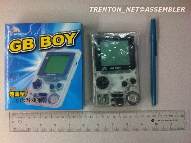

    Today we will be looking at several: The Subor Gameboy, GB Boy, Mini Boy, and Game Pocket.

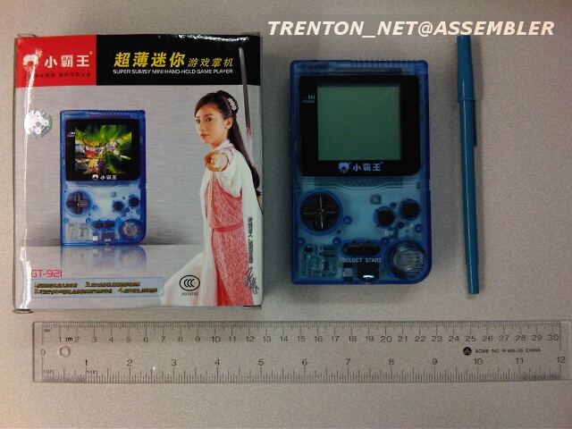

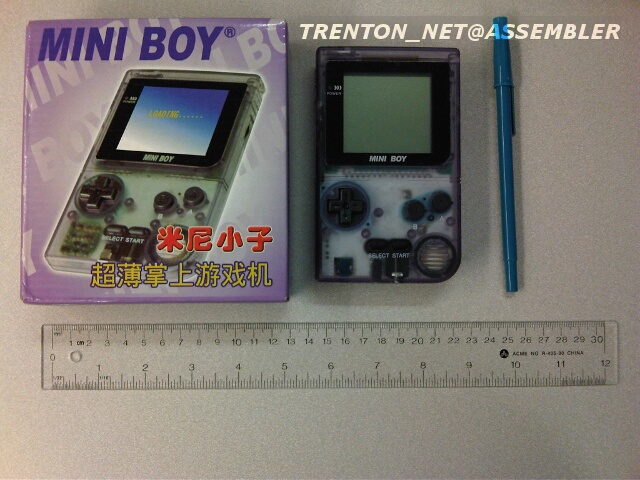

    As you can see, they all come in various packaging and styles. The Subor Gameboy has identical packaging front and back so I didn’t bother with the reverse side. Now let’s take a look at the actual hardware once removed from the box:

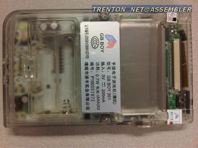

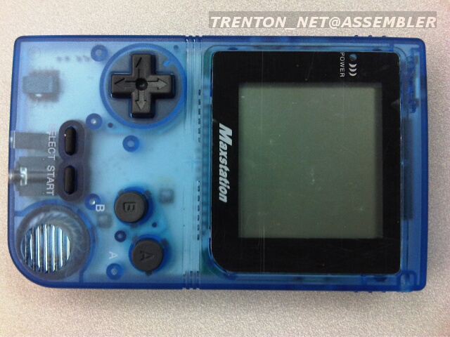

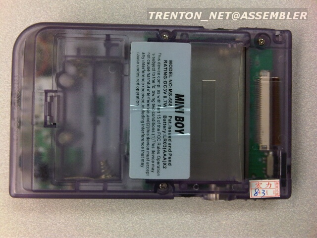

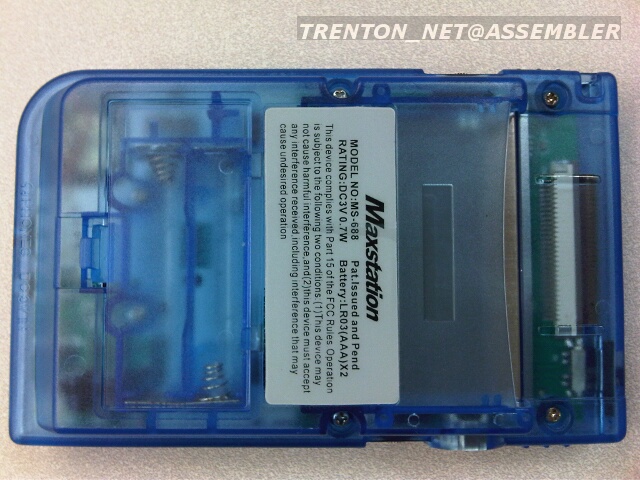

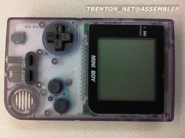

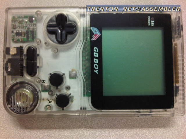

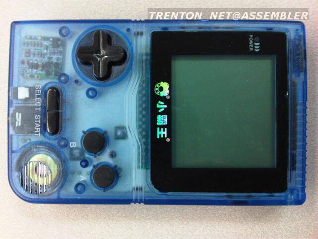

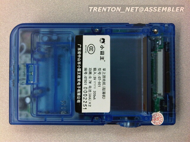

    As we can see, all these systems are based on the Gameboy Pocket. The Subor and GB Boy are both 2nd generation clones, while the Mini Boy and Game Pocket are 3rd generation clones. From the exterior they all look very similar. They all sport the same style casing, but each has slight differences. The 2nd generation clones have older hardware inside as well as Chinese control pad styling, while the 3rd generation clones have newer hardware and Nintendo pad styling. All systems have an audio jack, audio control, contrast control, Nintendo link port, and AC port. The following pictures depict the systems in greater detail, as well as how they look from the back. The screen on these systems will look better than they appear because I left the factory plastic protection on them.

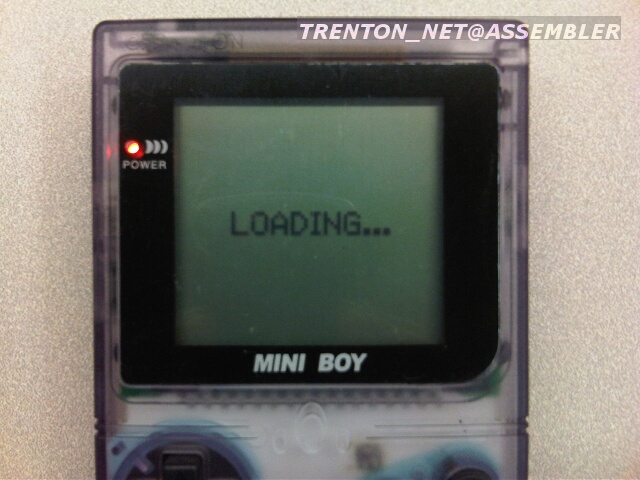

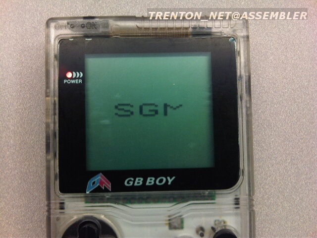

    Now that we have that out of the way, let’s power these units up. All units seem to run a custom BIOS, or at the very least, a hacked bios. The 2nd generation units show the logo “SGR” on bootup (I assume the designers wanted to leave their mark). The 3rd generation units make an attempt to be generic and show “LOADING…” on boot. I guess it’s easier to sell your clone plans to other companies that way. Here are some pictures of the logos. I apologize in advance for the blurry images.

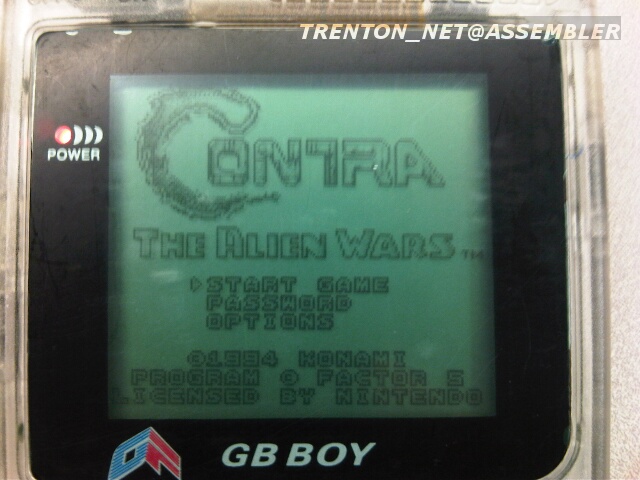

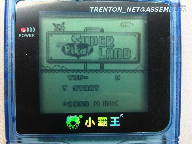

    As for the performance of these pirate consoles, they run very well. Although I only tried a handful of games, they all ran without a hitch. The screen and picture seem to copy the Gameboy experience nicely, and music and sound all works fine. Here is pictures of some random software running:
    Just about the only thing I can complain about is that the audio appears to play slightly faster (and higher pitch) than a real Gameboy. The difference is slight and some might not realize it, but if you’re used to a regular Gameboy you’ll note its running a tad faster. I wasn’t able to tell if the actual CPU and system was overclocked, or if it was just an audio issue, but it didn’t effect the system in any adverse way. Actually, this development was interesting in the fact that it explains why many Chinese original games (at least audio wise) run slower on real Gameboys, while on these clones they sound just right. Perhaps, in the case of Chinese originals, the system speed difference also makes sloppy code run a bit faster as well, but I honestly couldn’t tell if game play was any faster on a real Gameboy or clone Gameboy. For now, I’m just assuming they implemented the audio part a little differently since that’s the only part I can say for sure is sped up.
    I know I’ve talked a lot about the audio, but that’s really because there isn’t much else to pick at. Don’t get me wrong… I think the audio sounds great, but it’s just different than a normal Gameboy. Rather than keep talking, here is a sample so you can judge yourself. I just pulled out a random Chinese pirate cart and recorded some music from it.
