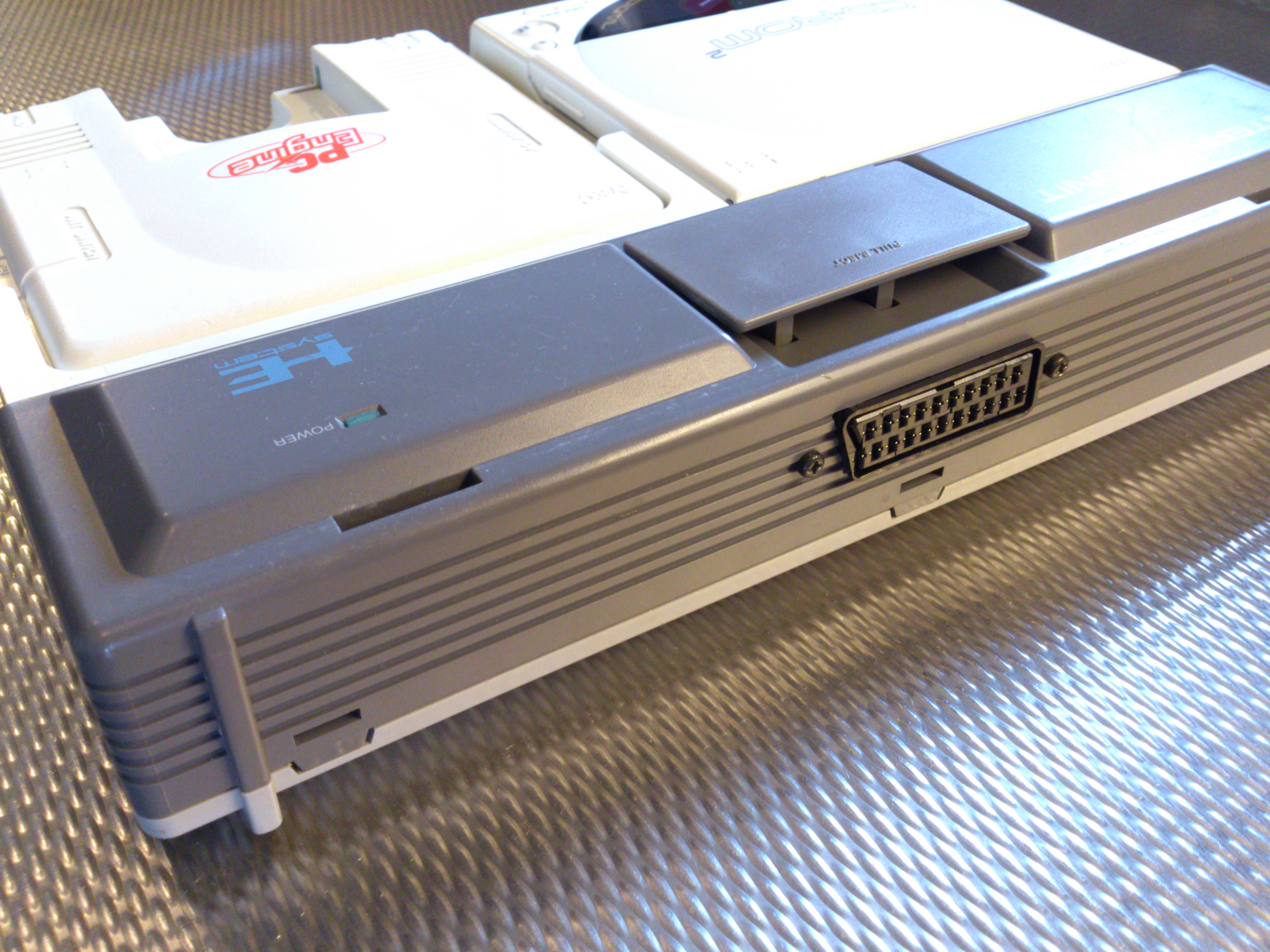

    FiddeSE Member
    Nov 30, 2013
  15. Goemon
    Goemon Enthusiastic Member
    Feb 4, 2013
    543
    Fitting a scart connector there should be quite annoying.
  16. FiddeSE
    FiddeSE Member
    Nov 30, 2013
    #16
  17. Kappa
    Kappa Peppy Member
    Aug 12, 2014
    300
    28
    England
    why use a scart connector when you can use a much smaller din socket? that way you would've saved loads of space and probably be able to route the power connector back there as well. imo that would be a much better/tidy solution ?
  18. FiddeSE
    FiddeSE Member
    Nov 30, 2013
    What would you do with all that space left?
    The thing is, when you'r from Europe, Scart just looks stock, we don't think about it as it looks like it's always been there.
