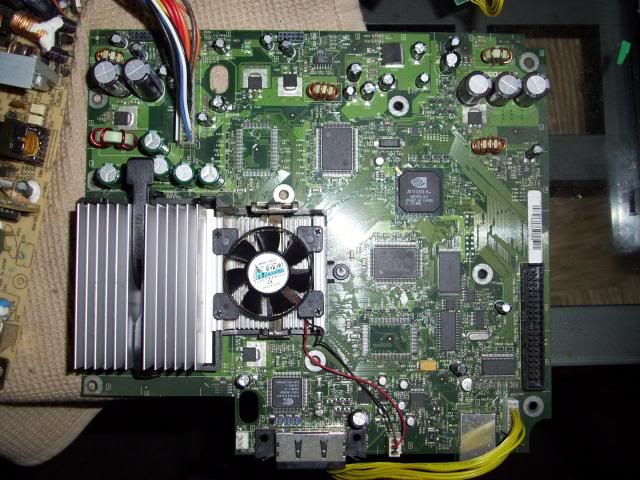

    Got the Xbox open! Microsoft really doesn't want you getting it apart do they? Aside from that fact they used security screws on the inside (who does that?) there's so many small parts and a LOT of them are held in place with clips. I never could figure out how to remove the mainboard power cable.
    Anyway, here's some photos, are any of these what you need?

    Your model is a 1.0, the first version to come out. It has a 1024K TSOP chip on it. A revision 1 is easy to identify because of the fan on the smaller heatsink and the single row PSU connector. 1.1 also used the single row connector but has no fan on the GPU heatsink (the smaller one). 1.2 onward used a plug exactly like a standard 20 pin ATX connector but wired differently.
    I assume the fan on the GPU is stock and not a mod. Hope this helps.

    Ya gotta be kidding! Even just getting the shell apart involves ripping off the rubber feet and peeling back two stickers to even get at the screws (and even then, you need a special type of screwdriver). And if you're completely pulling it apart, there's a lot of plastic that needs to be gingerly bent to release the part (there's five tabs on the faceplate alone). Hell, even the RF shield needs some metal tabs to be bent to release it from the shell! So far, I've found the Xbox to be the most time-consuming console to dismantle.
    Cool, so this model is perfect for the TSOP mod? Will "Agent under Fire" be a suitable exploit game to get the ball rolling? Where at those points I need to bridge? And yes, I've pulled it apart just now, so it's stock :p

    Flash the X2 5035 bios since you have 1MB TSOP. (has the most features)
    @Sonicdude. The board is 1.0 because there's no controller plugs on the board, and the GPU fan is present.

    Okay, I've placed an order for Agent Under Fire (black label version) so we'll be able to get this party started! On the hardware side of things, I just need to join those two solder points right? Would the console be okay to re-assemble at that point, or am I going to need to open it up again?

  19. HEX1GON
    You'll know the features in the readme file.
    You can assemble the console again once the joints are connected.
