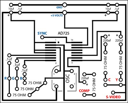

    I don't know if this will help but I found this image a while back, it's a circuit print for an AD725. You can print it on a transparency and then iron it on a blank board then soak in chemical and have yourself a PCB. Never tried it myself.
