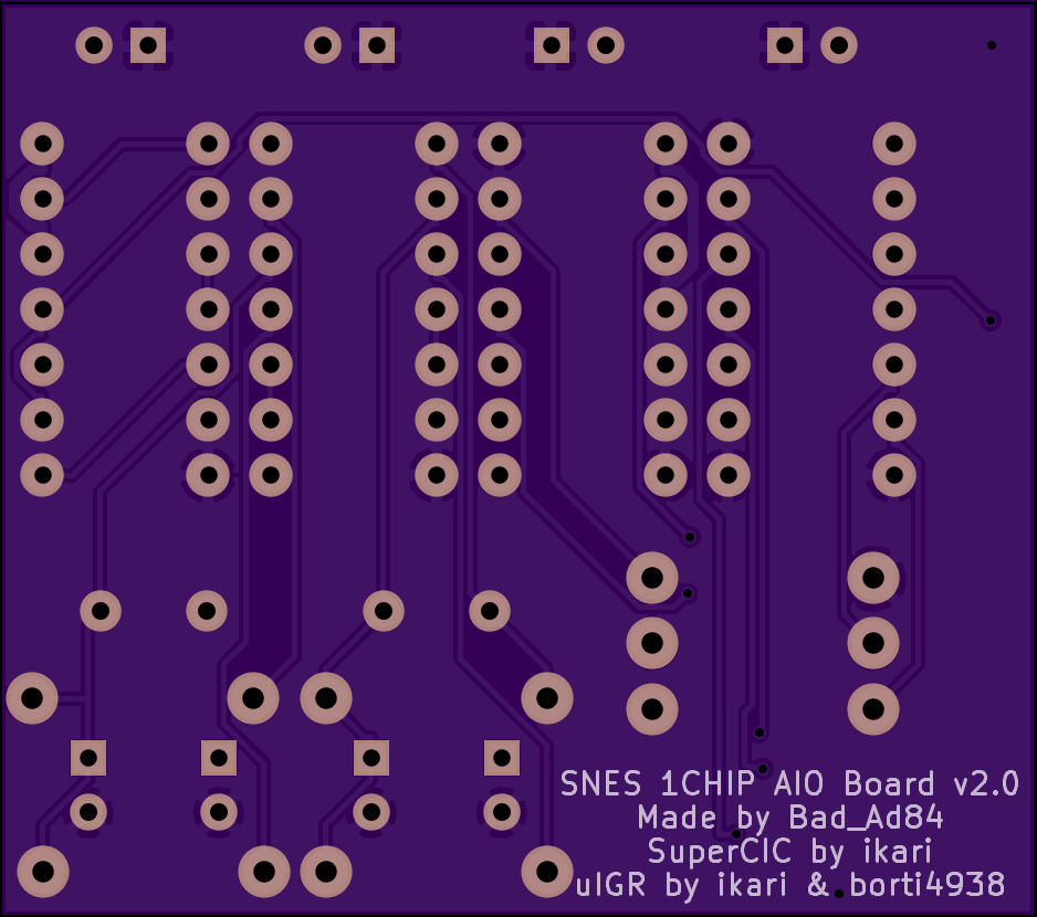

  3. Bad_Ad84
    7,087
    280
    There is already another revision in the pipeline. Also change of supplier with min order of 10, so will be more for next round of testing.
    #23
  4. Bad_Ad84
    7,087
    280
    v2 with fixes from tester + uigr support
    Will contact testers when boards arrive.

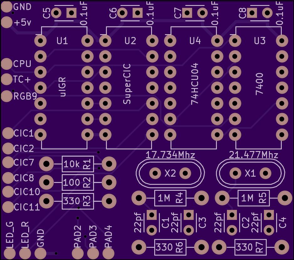

  7. borti4938
    borti4938 Spirited Member
    May 8, 2014
    137
    23
    Nice :)
    I just have one thing to note: the region timeout (set console 9s in region of the cartridge on powering on) is managed by the uIGR! This makes the region timeout by the SuperCIC useless (but it is not a problem if it is enabled because the duration of the region timeout is almost the same length - the user won't recognize)
    I added some hex-Files for the uIGR, where the region timeout is enabled by default: URL to my GitHub
    If you use the Hex-File with region timeout disabled your testers might get "This gamepak is not designed for your SNES/SFC" on the very first start up (depending on the game) as the uIGR starts in 60Hz the first time (not the SuperCIC 60Hz mode).
    So, some suggestions for version 2.1:
    - connect SuperCIC pin 4 to GND instead of Vcc
    - give a break out for uIGR pin 7 (region patch enable/disbale), because someone might want to install a region patch too (for example this design here; not compatible to SNES Mini/Jr. for any reason the designer don't know)
    #27
  8. Bad_Ad84
    7,087
    280
    Region patch will be added in next version anyway.
    I just didn't find a lot of info of what is required before I decided to do another revision.
    Do you have more details of the region patch?
    And thanks for the files, that's how I expected it to work based on igr and supercic.
    #28

  13. Bad_Ad84
    7,087
    280
    Thanks,
    I think I will do this as an extra PCB, because my current PCB is under 5cmx5cm. If I go larger, it starts increasing the price. I will add some pads for v2.1
    #33

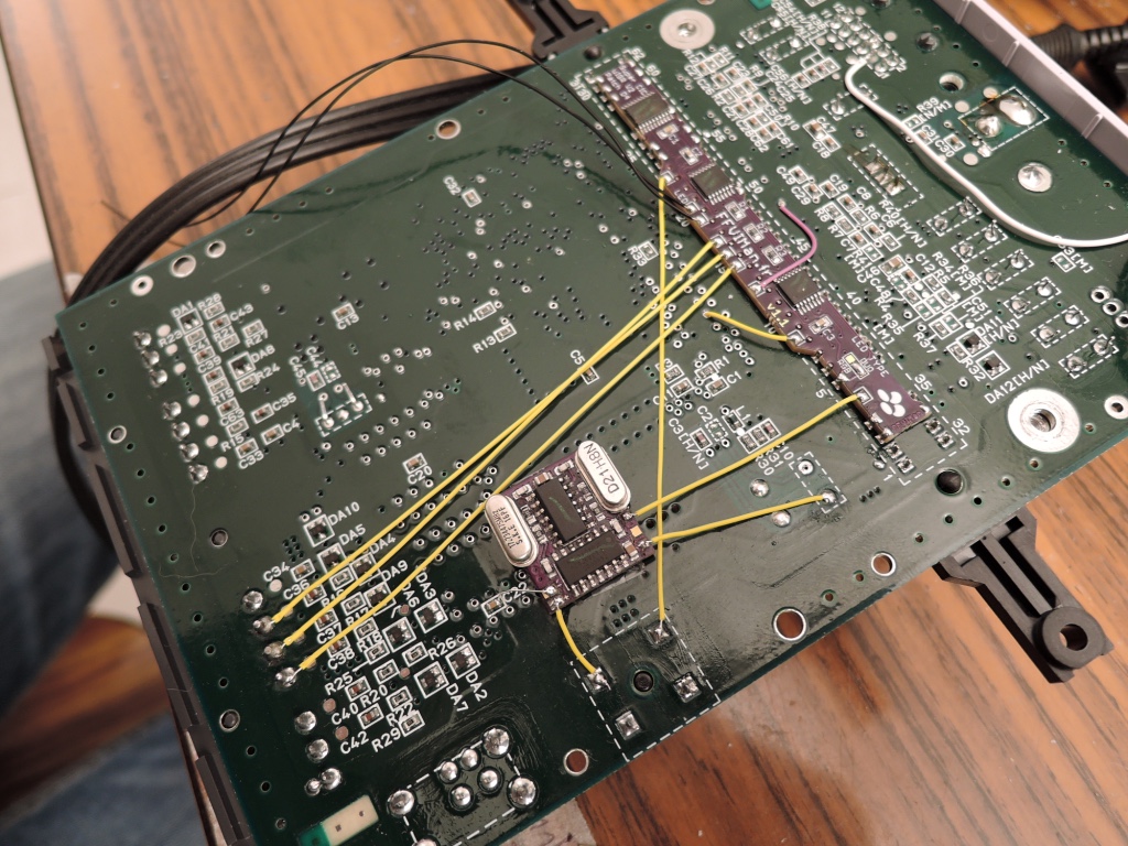

  16. TriState294
    TriState294 Site supporter 2016
    Feb 20, 2012
    166
    I got the V1 board you sent me today. I attempted to install it in a SNES Mini (NTSC). I'd love to confirm that it works, but I make a rookie mistake installing it instead. Just as I was going to put the board back into the bottom case to test it out, I put too much pressure on the CPU pin lift and broke the pin off. I should have glued it as soon as I had a wire soldered to the pin, but I thought I better wait until I had tested it. I have a spare CPU chip from another 1CHIP SNES that I think probably works, but reworking 160 pins without a hot air station is more than I have in me tonight. I will give it another try next week when I get more Chipquik or possibly another SNES mini to put it in.
    I do have the following thoughts from my experience with the V1 board you sent me thus far though:
    • There should be a ground next to the LED pins on the mod board -- but I see you already made that change in V2...please keep it.
    • The silkscreen for "CIC 11" is cut off by a via -- again, probably not a problem on V2, but just thought I'd point it out.
    • When the definitive guide gets written up for this mod, I'd suggest soldering to the vias for the CIC rather than the chip itself. Its really hard to get two wires to stick to those pins without bridging. Every pin has an accessible via except CIC pin 7 (if I recall correctly), which has it's via under the CIC itself. Also, solid hookup wire seems pretty much required here. Any reason not to use really thin wrapping wire for these connections?
    • Do you have a recommended location for tapping 5v and ground? I was thinking of just using pin 1 and pin 7 from the controller port. If that's going to be the recommended install point, maybe the mod board should just have these points labeled pin 1 and pin 7 and put them next to the other controller pins for a cleaner install.
    Additionally, I have the following comment about the discussion of V2: If you want to add the region patching circuit, but don't want to exceed 5cmx5cm, maybe consider a daughterboard design. There seems to be enough space in the SNES mini that you could solder bridge two boards together...the main board for just uIGR and Super CIC, the daughterboard if you need region patching as well. I have to assume that some people don't really care about region patching because all they are using is a SD2SNES (and the SD2SNES automatically patches ROMs in this way, correct?). SD2SNES users are primarily installing this for IGR and 50/60hz switching. By making two boards that are separate but matching, the end user can decide if they need the region patching or not.
    #36
  17. Bad_Ad84
    7,087
    280
    Most of the cic connections are actually on the cart slot.
    Region patching is going to be a separate board - this was mentioned above already.
    The rest of the changes were already done.
    For your CPU pin, just Dremel the chip and expose the connection that way
    #37

  20. malcolm
    malcolm Active Member
    Jan 11, 2015
    35
    V1 Board delivered and installed and tested.
    SuperCIC works exactly how it should, all modes and any cartridge work great. Colours look great via composite in both 60 and 50hz.
    IGR all worked except setting supercic to auto mode L+R+Select+B does nothing. however V2 has UIGR so this is likely rectified.
    The concerns i have are the same as tristate294, and good to see they have all be addressed with V2.
    In the next day or two i plan on installing this board into a PAL 1chip-01, and taking a series of photos to hopefully create a simple to follow install guide. which may or may not be relevant for v2 of this board, perhaps the photos prior to connecting to the mod board might be useful.
    I am really looking forward to the final product, the thought of having a board where i can just pop the components in is really appealing. one of the time consuming parts of a 1chip supercic is creating the mod board.
    @TriState294
    Not sure if this is relevant for the mini, but i grab 5v and G from the controller port connectors on the motherboard. also there is a convenient gap where the cables can run off and to the mod board. Also can grab controller port pins 2,3,4 from there. not saying its the best way, just seems to be the most convenient and can keep cables close together. attached is a photo i did of supercic from about a year ago, recently i have been using this board to test 50hz colour corrections.
