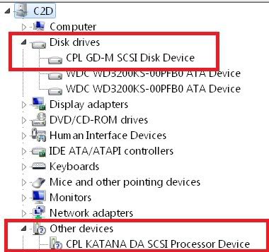

    If the installation is successful, you will see this:
    - When this is done, you will see the two devkit devices in the device manager:
    - If you don't see them, a reboot might help.

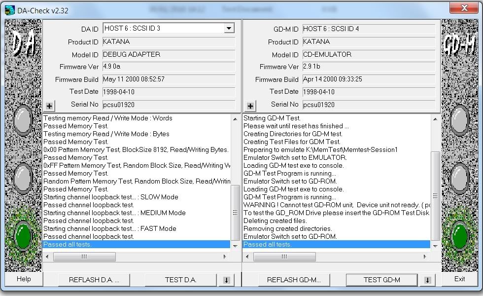

    - to check if everything went well, I would run DACheck & test the DA & the GD-M... if you get error messages or don't get two green buttons at the end, something's wrong...
    This was the result on my pc:
    You're now ready to execute the Katana SDK applications again !
