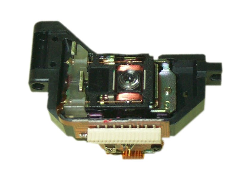

    Yeah, i just laid a hand on one of these and it didn't worked either... just to be clear, this is the laser, right?

    it seems to be the same laser i used. but mine has 3 holes in line on the left side.

    Yeah, that differs between batches. And between the drives containing them too.

    today i finally received the cd-rom drives. but there are 2, not 3:
    1. COMPAQ CRD8322B(CP1) with the same laser SANYO SF-P151
    2. BTC BCD F564E with the laser PXR-560X
    So i tryied the PXR-560X laser. It doesn't work. The same thing happens.

    BUT not all lasers have the same pinouts, I remember thinking about changing a console laser years ago and had 3 drives, each one had a very different connector, spacing and number of pins, just be careful!

    Unless you get the same laser or an equilivent type, it will not work.
    And out of the 30 something CD-ROM drives I have, none of them are interchangable with a PSX, dreamcast or each other.
