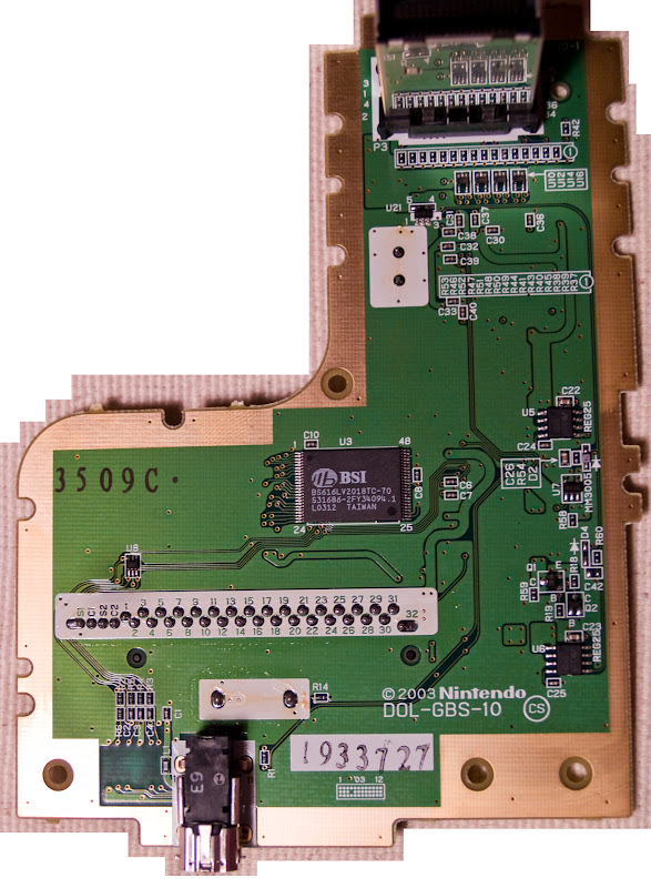

    Currently having an interest in the finer points of ARAM, I set out to see what I could see, and found myself yearning to know how a Gameboy Player makes use of the bus. Unfortunately I could find no scans of the internals at all, so I couldn't really even make educated guesses. So I went out and got one (if you can find them...the stores are pretty much giving them away... :thumbsup: ).
    I was pretty bummed to see they actually use an ARM core on this board, I was hoping all the magic was done in the "start up disc"...oh well...
    Anyways, here are the shots. Head over to this album if you'd like the first shot in highres.

    Not much to see. Oh well.

    Yeah, not too much magic in these startup discs. AFAIK they only serve to setup the GC into a kinda "video pass-through" mode. From what I've read about them, Datel's GB Player clones are on the other end of the spectrum, with the hardware acting as a simple adaptor to get to the ROM data and everything else running in software emulation. Maybe that's more to your liking? (Then again, if it was, you could just look at a GBA emulator's sources instead...)

    It looks like a pair of funky platform shoes :)

    Yours has an extra errata resister soldered to a test point. Any ideas why or what it does?

    not at the moment...maybe this would be a good time to ask for an AGB core pinout? :)

    Sorry to bump this old thread. The Crystal in your picture is a 33WKSS3CT. While the one in my EU Gameboy player is 33WKSS3BT. I can't seem to find either using google or searching on digikey, so I was wondering if anyone knew if there was a difference?

    Sorry for bumping an old thread, but I've got some appropriate research data to share and this thread seemed appropriate.
    I agree you can't exactly match the correct frequency simply by changing the crystal, but if you can get close enough it could increase the period between doubled frames to several minutes, assuming that the software doesn't need any modifications. I recently decided to investigate this possibility.
    I discovered that TP29 on the board allows you to read the vertical frequency. I measured 59.73Hz using an oscope which is the expected value. (Technically I measured 59.72 - 59.74, average 59.73.)
    Next I attempted a proof of concept by replacing "Y1" with some crystals having commonly available frequencies to see if the vertical rate could be manipulated. This failed.
    I tried several crystals in the 4MHz range and they all yielded a vertical frequency of around 28.8Hz although the value fluctuated (28.6 - 28.9 although some imprecision can probably be blamed on the oscope settings-I'm not very experienced with them.)
    Next I tried some crytals in the 8MHz range and here's where it gets strange. The vertical frequency did not change! It was still around the 28Hz range!
    Then I tried putting crystals in parallel with the original, like the author of the GBA overclocking tutorial did, even though that was a completely different device. This had no effect on the vertical rate which remained at 59.73Hz.
    With nothing connected you get nothing so there doesn't seem to be some other unexpected source generating the 28Hz.
    Some loose ends: I don't actually know if the game runs at half speed this way as I never had video connected during this experiment. I was only measuring TP29. Also be aware that you need the boot disc and a game cart installed in order to get the GBP to start running where you can measure things.
    Summary- Changing Y1 for crystals of 4-8MHz yielded 28.8Hz vertical frequency on the GBP. This is bizarre as the original crystal is expected to be 4.19MHz and it gives 59.73Hz.
    At this point I'm stumped. Can anyone explain this behavior? Any other ideas to try?
