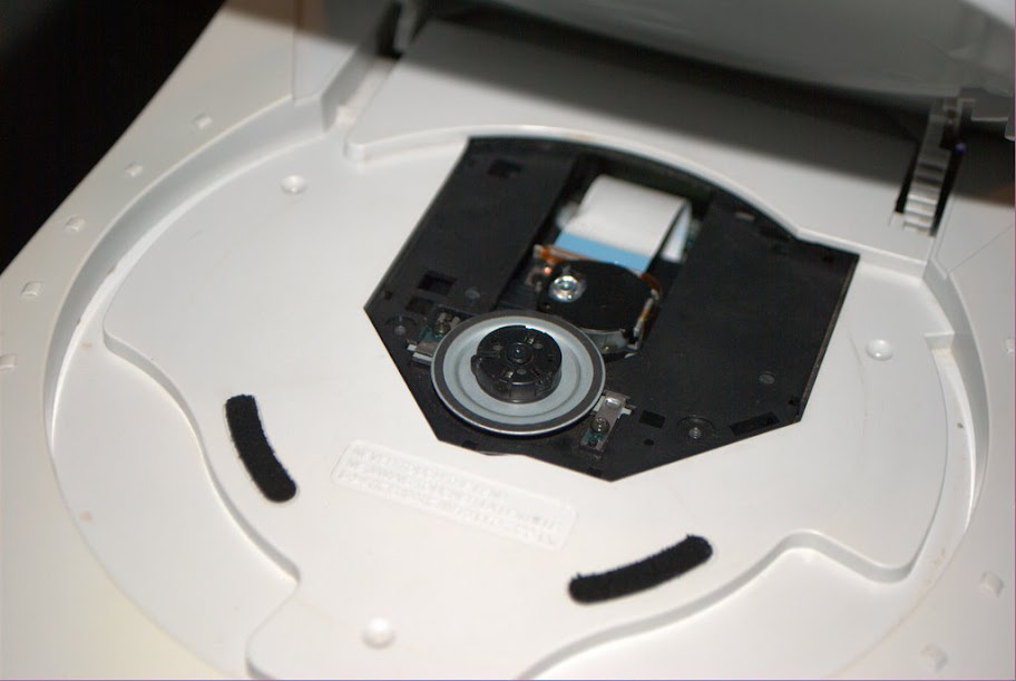

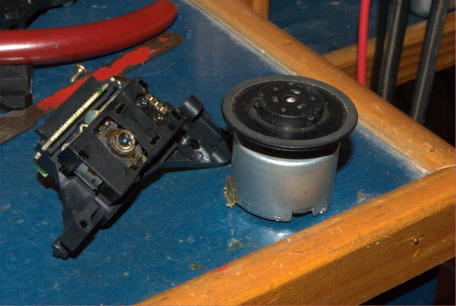

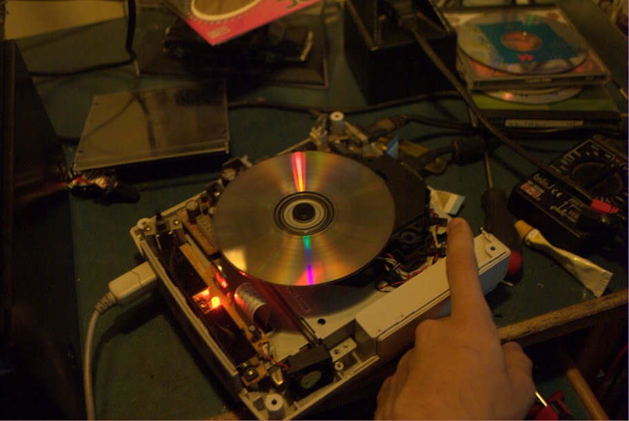

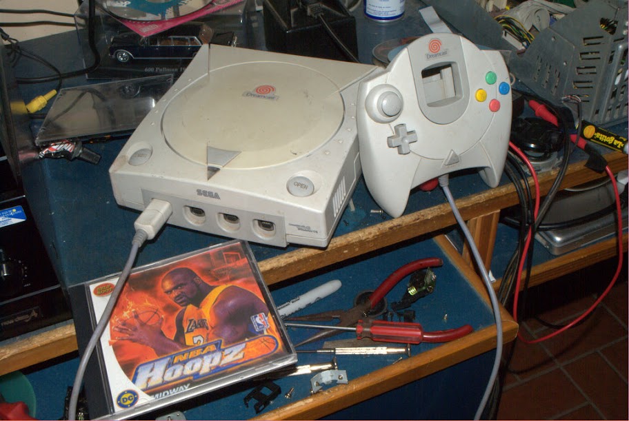

    i'll post some pics of how i repaired my DC, it was free from a friend had the CD Drive extensively damaged, no only laser if not a broken spindle motor and broken cd hub (the thing that grabs the disc). may you say that it will not value the effort but the DC is my favourite game console and are quite rare here, so, enjoy the pics :)

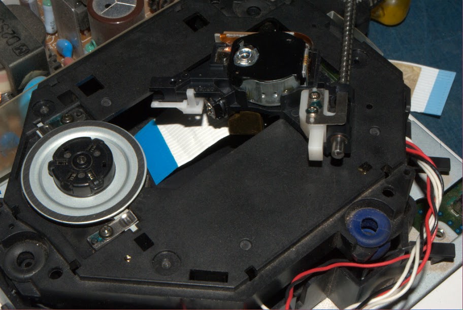

    Hi! in fact every lens i've tried on it worked, but had too much distance the disc from the focussing lens, and this is the only one that worked, all of them were form pc drives, the one on the samsung mascter 48e was exactly the same than my dreamcast has but the same issue of the distance, the one used i used is an SPU3200, was from an extremataly common cd drive an 32x aOpen.
    this one: http://www.recycledgoods.com/images/s_p_20431_1.jpg
    i think the lens you can get if new as is may be used on cd players for hifi, is a philips lens.

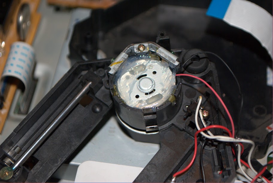

    PS doesnt the fact that the drive motor is only hot glued in place(not dead center) make the disc wobble a bit, is the laser having any problems following it , or needs to adjust regularly to keep itself in focus?

    i forgot to mention, the PC drive had an extra pin which can be omitted, in the picture doesn't notes because i've also used the flex of the pc drive, follow the trace and one of the side pins goes to the photodiode (the transparent IC) that is the one that you must left unconnected. the "new" lens is going to need a recalibration.
