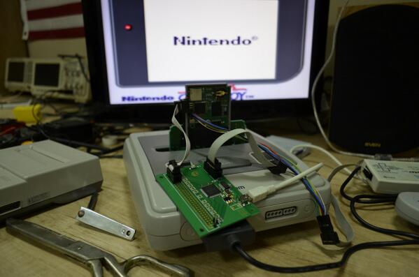

  20. CAPTAIN N
    CAPTAIN N Rising Member
    Oct 30, 2011
    Looks good so far :)
