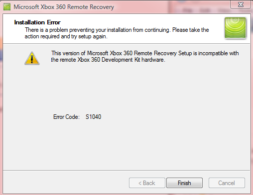

    Also, here is the message I get when trying to recover 20353 or less

    Ive had that error on a phat console before, it was something to do with the format of the drive... or in your case the the onboard memory. In the xdk dashboard settings there should be an option to toggle the internal memory on and off. Try disabling it and running the recovery again.
    Let us know how it goes, too many threads like this end up resolved but without the solution documented for anyone experiencing the issue in the future.
    Fingers crossed!

    Thanks mate, tried it, but again, just crashes and gives me the same error. It recovers to the latest recoveries just fine. I'm maybe thinking its actual physical hardware limitations somehow, these are odd kits. Did you ever manage to dump you white S's NAND? It wasnt 4GB was it? :/
    EDIT: Also just tried 20675 and that failed too :/

  12. XboxSurgeon
    1,526
    390
    Have you run xbdmrecovery.xex on your kit? If so it'll cause errors with remote recoveries until you first recover with an iso based recovery.

    Not ran xbdmrecovery.xex, I did run InternalDriveLinker.xex? Are there any .iso recoveries available on a recent recovery? I could use an .iso if it was high enough, but nothing that low works
    EDIT: Found 20871.2 and 21119.10 isos, Ill try 21076.11 remote, and if that works I guess 21119.10 should work
    21076.11 works, I'll download 21119.10 now and try a disc recovery
  14. XboxSurgeon
    1,526
    390
    Yeah try an iso recovery and then re-recover with the newest remote you have later. Hopefully will do the trick. I have downgraded a trinity XDK in the low 9000's before without an issue. But as far as Corona, mine came with a 21000's recovery so I never downgraded below that. Currently running 21256.3

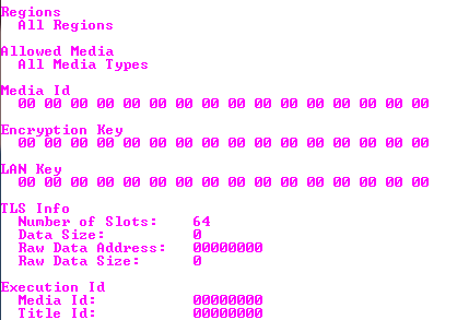

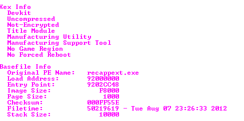

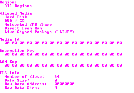

    Really dont know which one to believe, Ill have to compare with another xex soon but they are practically the same
    Except for Allowed Media
    .xex
    xex.orig
    Ill report back
  18. deep3r
    deep3r Intrepid Member
    Feb 6, 2011
    681
    134
    An original xex comes back same as the .orig, I guess it will be fine just to delete the xex and rename the default.xex.orig to default.xex within the .iso
