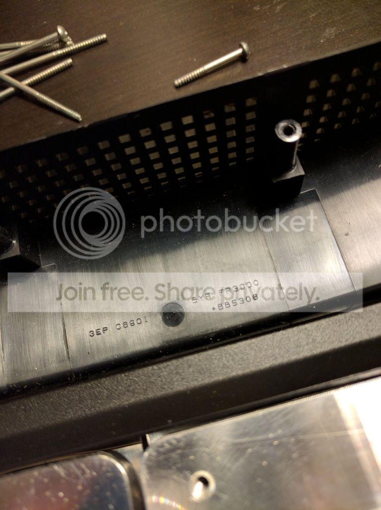

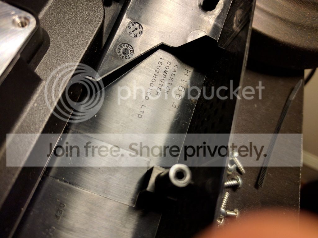

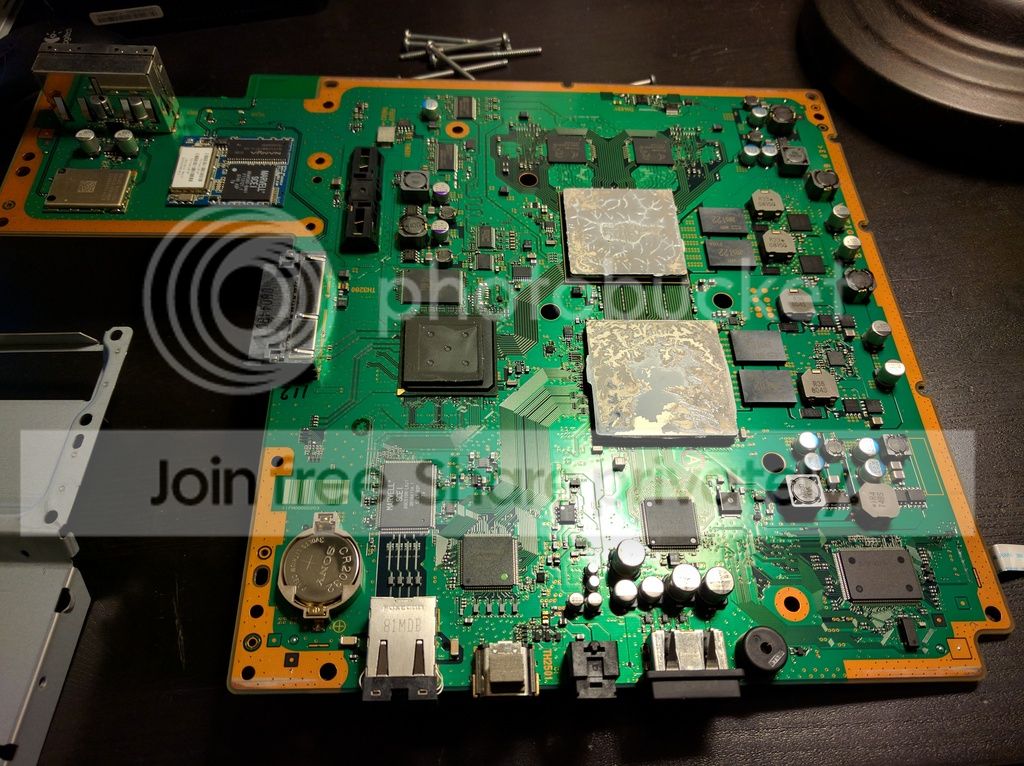

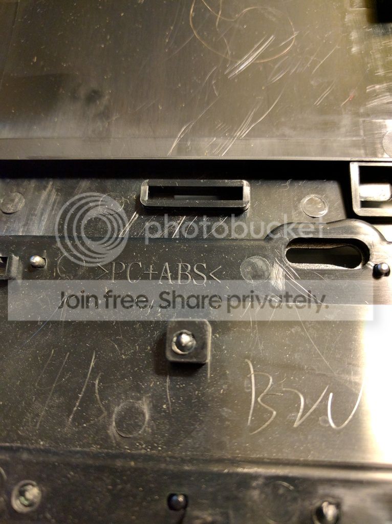

    Just typed out full update and lost it, so this one won't be as long
    I opened it up tonight. These markings don't look like something I'd expect on a retail console but I don't have another at the moment to compare.
    Also, the mobo appears to be the Vertigo-02.
    Thanks to everyone who has been providing me with information on this one, it's been a huge help. I'm not going to touch it until I know what we're dealing with and whether a NOR dump will be safe.

    The one in this thread clearly isn't that old - you can see the mold dates in two of the photos and they are both April, 2008 - the photo of the main board isn't high enough resolution to allow the date codes on the chips to be read, but that's a good indication of when it was built, too.
    It's also worth checking to see if the board has one of the standard Sony style part numbers on it (0-124-456-78) - the first digit tells you if it's a board that was produced by engineering (0-) or is full production spec (1-).

    Taking some hi-res photos of the chips would be useful - the date code is generally a 3 or 4 digit sequence with either the last digit or the last two digits of the year followed by a week code (Normally the EIA week code, which doesn't line up perfectly with the calendar year).
    Apart from that, all you can really do is look at the boards and compare them with retail ones.
