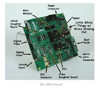

    ORCA
    [​IMG][​IMG](NINTENDO GAMECUBE Development News, v4, somewhat paraphrased):
    The ORCA board is the heart of every development solution. It
    contains the CPU, the graphics processor, and the main
    memory. Although there are different versions of the ORCA
    board, they are all designed to work in the DDH, NPDP-GDEV,
    and NPDP-GBOX.
    ORCA boards are supplied with the following daughter cards:
    -Video card. The final video card has the component video
    connector and a final-spec 9-bit video DAC.
    -EXI boards. These provide a hardware interface for EXI
    devices.
    -Boot-ROM. This contains the Initial Program Loader
    software.
    -Serial connector. This provides debug output directly from
    the ORCA board, and accounts for one of the communication
    channels of every ORCA-equipped system.
    FINAL SPECS FOR ORCA
    CPU clock speed..........486
    GP clock speed............162
    Audio DSP clock speed..81
    Main SRAM..................48MB
    Boot ROM....................0.93A

    The USB2EXI pictured above is a beta version.
    The one below is final. The connector looks more like a memory card, but functionality was the same as the beta.
    Memory card emulator
    This has eight dip switches on the front, five being active.
    It is used to debug and develop games by allowing the user to emulate the full range of memory card functions in realtime. It is simple to use and it works on all GameCube systems from development to retail.
    Dolphin Controller Test
    This is a beta controller from around 1999. It uses the same RJ-11 connector that the AMC DDH beta used.
    Beta ORCA specs
    D=revision
    D1...............HW1_Drip (4MB RAM prototype)
    D2...............375/150 clocked HW1
    D3...............375/150 clocked HW2
    D3.4, D4.4....486/162 clocked HW2
    D5...............Final spec (See ORCA part of this post)
