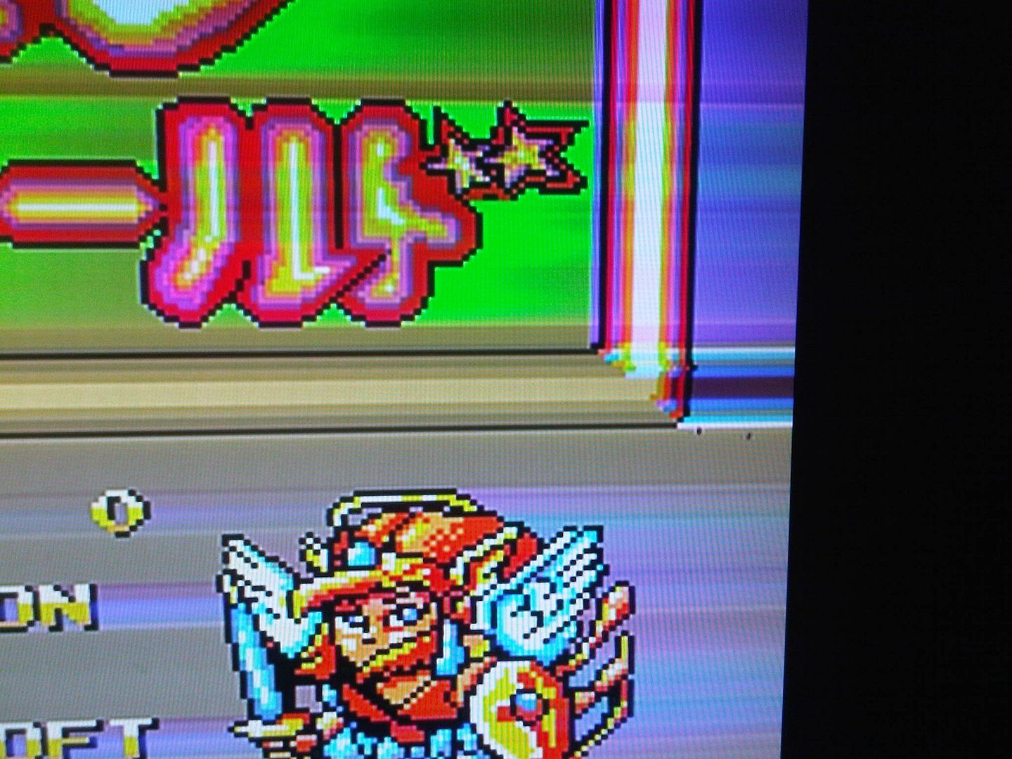

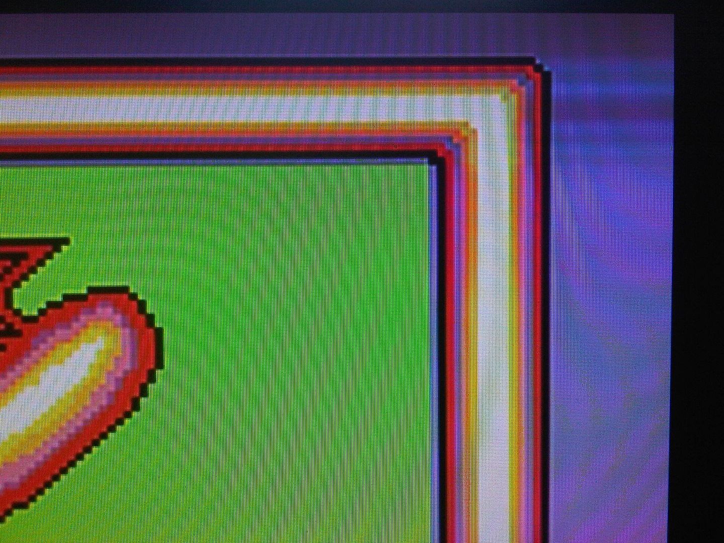

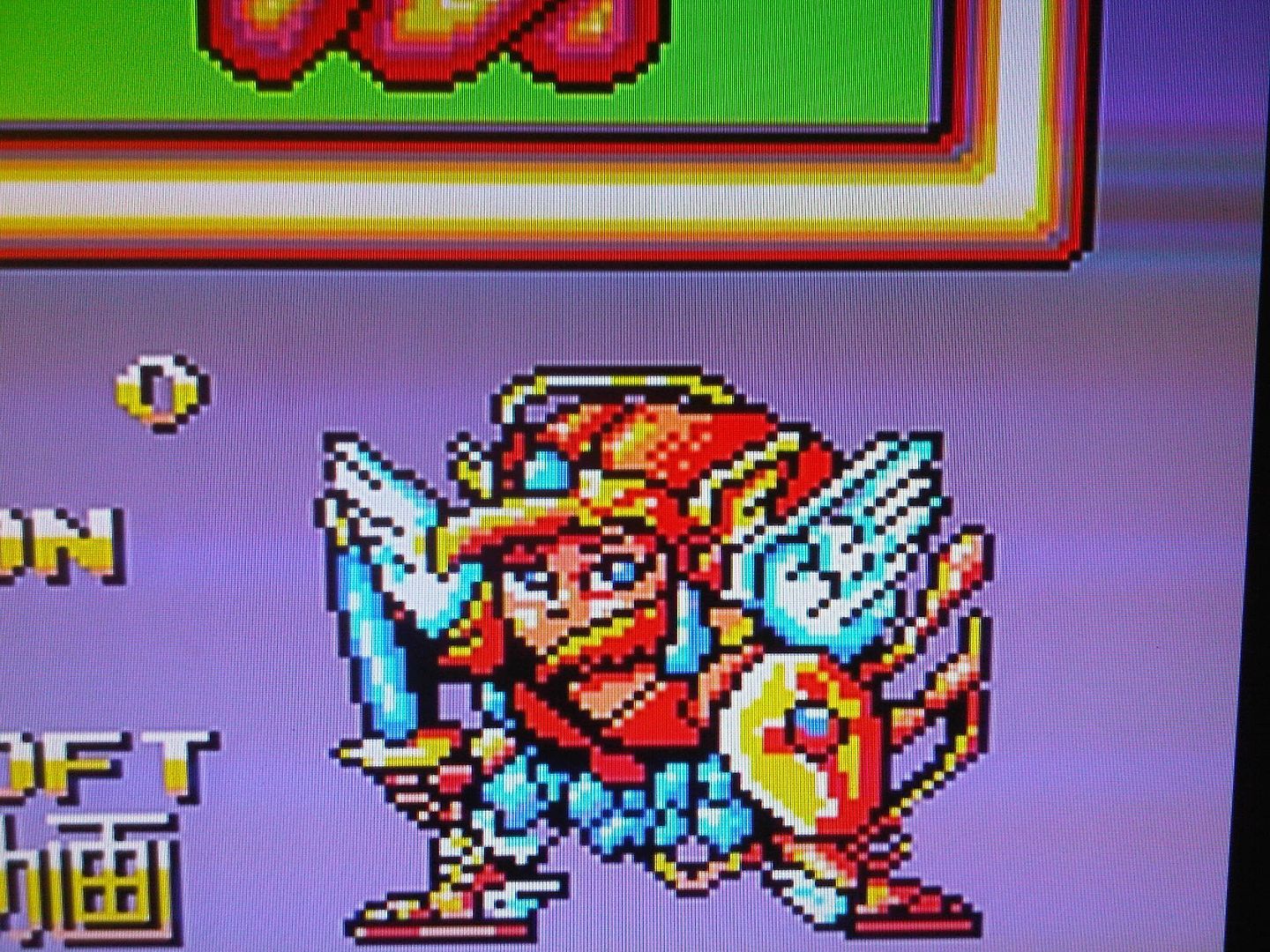

    OK finally today I managed to do some testing:
    it's a half-assed test mind you because the 100 and 200nf caps have not arrived yet. I used some 68nf caps for the test , so they are the wrong value. I also did not put a cap between gnd/vcc because I did not have another 68nf one.
    I also did not connect to the GND the BYPASS+DISABLE+NC+NC pins, they are all just NC. I did not get a picture with them all connected to GND and I thought this was to blame LOL. But I found out later that without the caps there was no picture at all. With the 68nf ones I get this result:
    I suppose when I try the 100 or 200nf the picture will improve...
    edit: found another 68nf cap, put it in gnd/vcc but made no difference as expected... got some more shots though, I have moving pixels in the upper left , upper right and lower right corners of the logo box, where you can see the gfx errors.

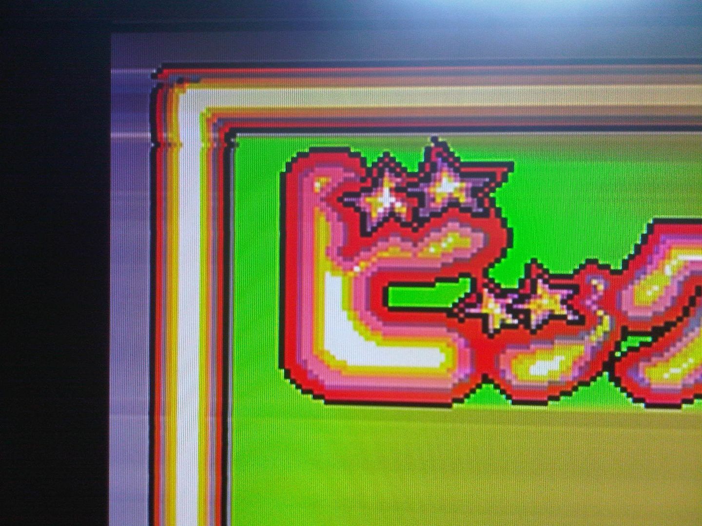

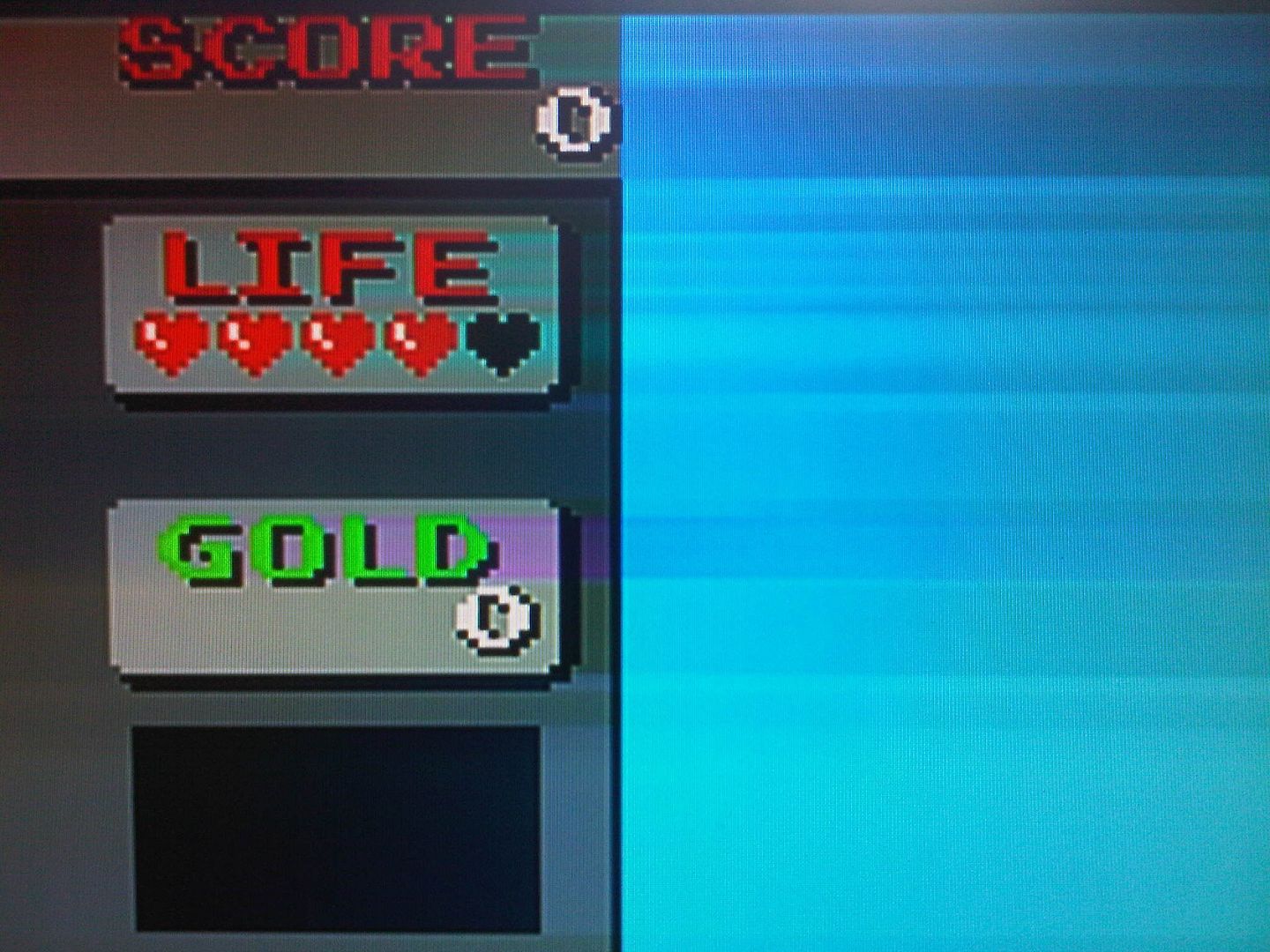

  17. keropi
    keropi Resolute Member
    Feb 2, 2011
    987
    36
    Greece

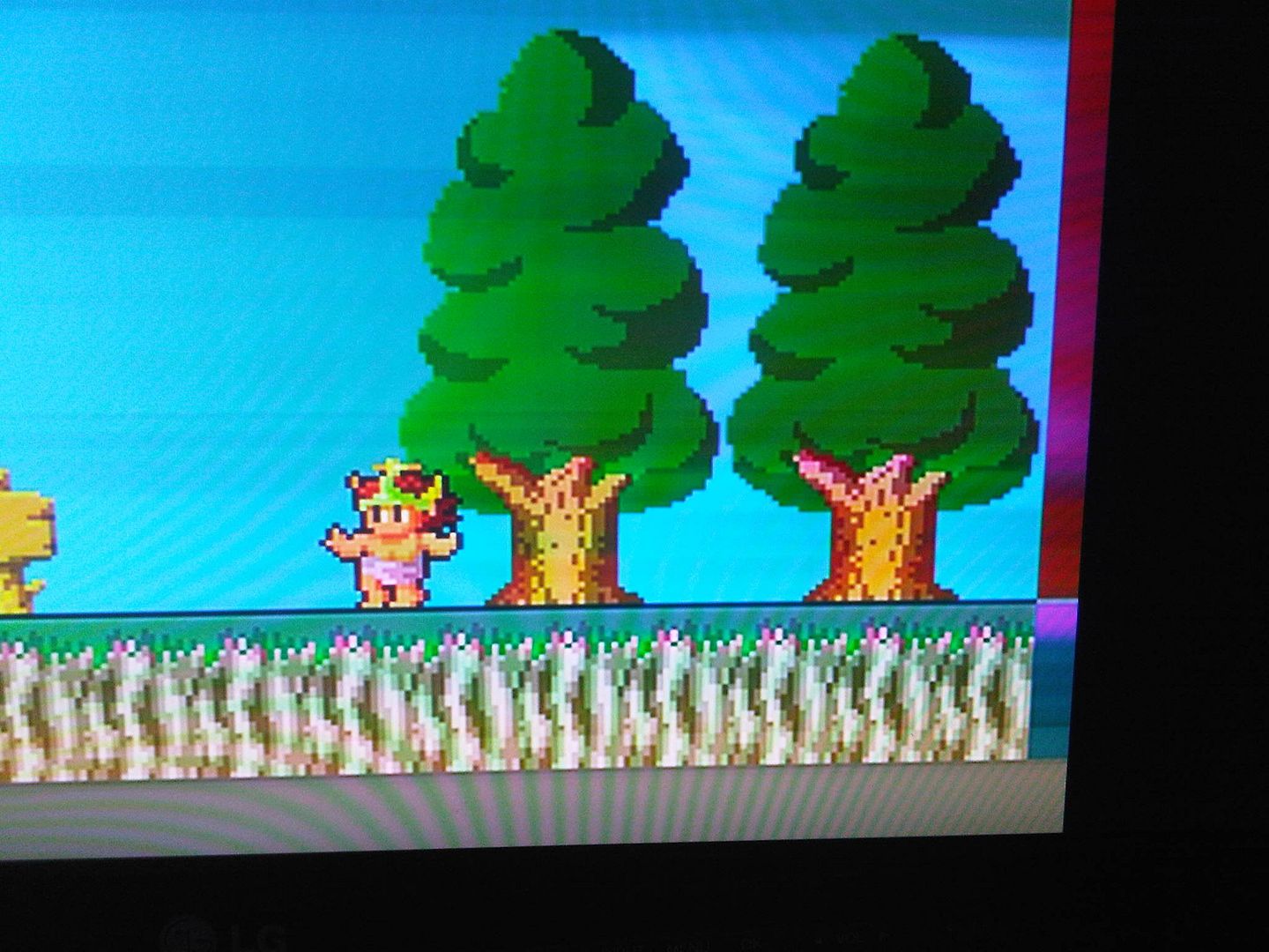

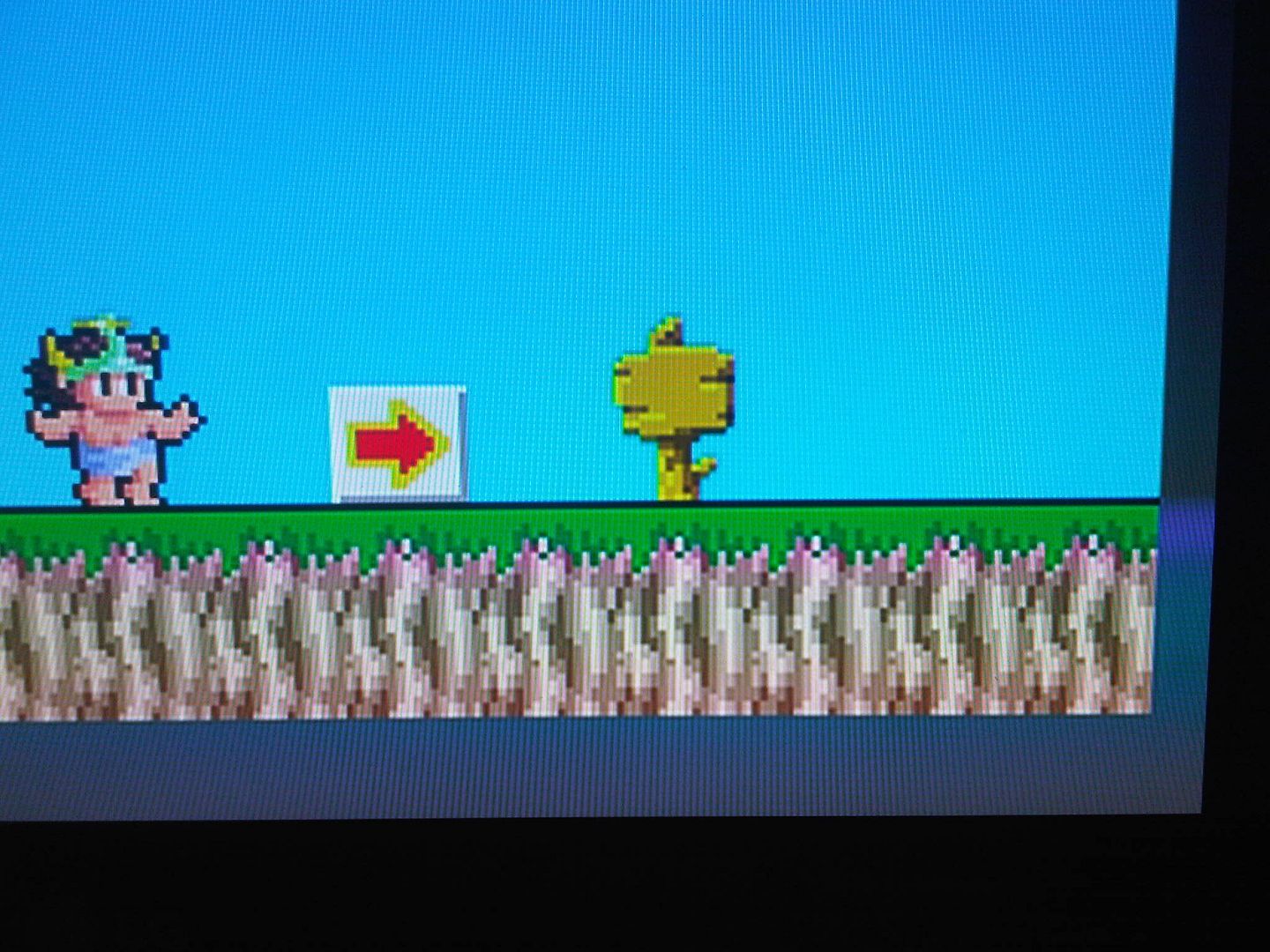

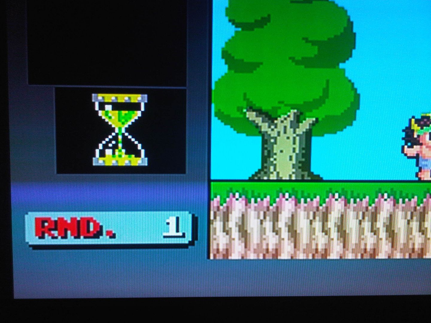

    100nf caps made a huge improvement (this time there is a cap between gnd/vcc and all unused pins are grounded) , there is still some discoloration effect mainly in the top and bottom parts of the screen though , and judging from the title screen there is also some kind of ghosting(?) when the color difference is great as it shows in the bottom corner of the logo box.
    [​IMG] [​IMG] [​IMG]
    still waiting for the 220nf ceramic caps, but I can't help but wonder if 220nf is way too much...? maybe I need to search for some middle value (if it exists) ?
    edit: also tried on a CRT tv, I get the same effect... when there is an object with great color difference it creates a horizontal "shadow" across the screen... for example the 1st moving platform in wonderboy creates a shadow that moves across the screen with the platform, seems like there is a luminance drop or something... also notice the grass on the ground, it has pink in it...

  18. Calpis
    Calpis Champion of the Forum
    5,907
    .ma.us
    The datasheet recommends 100 nF, and also specifies the input impedance to be 800k ohm. Together they make a high-pass filter corner frequency of 2 Hz... This is PLENTY low enough. You can use higher capacitors, but it won't make any difference.
    You REALLY should follow the recommendations of: putting a 100 nF decoupling capacitor across GND and 5V, also a larger electrolytic, like 22 uF across them as well to minimize power supply ripple (not as necessary). They also specifically say to not leave the control signals floating! GND DISABLE and BYPASS.

  19. keropi
    Feb 2, 2011
    987
    36
    Greece
    Thanks for the input Calpis but keep in mind that on the 2nd attempt I do have 100nf ceramic caps in all inputs, all extra pins are grounded together and there is a 100nf cap between GND+VCC , just like the rough drawing I did before:
    it seems to me that it needs some slight tweaking to get it perfect on the PCE... but I have no idea what to try next

  20. Calpis
    5,907
    .ma.us
    I don't think you should GND NC. Also your 100 nF decoupling is probably not effective (can't see how you wired it), you should solder the capacitor directly to pin 9 (GNDed) and pin 10.
    The only way to know for sure what to do next is to use an oscilloscope on the signals... That way the levels could be verified in and out of the amplifier. I think they are fine though.. The interference is low frequency like a GND loop. Does the interference stay static or does it move around? Try larger capacitors at the input and see if that clears it up. If it doesn't I suggest decoupling 5V with the 22 uF cap.
