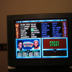

    I got a modded to have component output original SNES off ebay.
    This is vivid option on the trinitron.
    Even on standard it looks blueish. Its like they picked colors that just didn't wanna play nice. Banding all over and the vertical bar but faint.

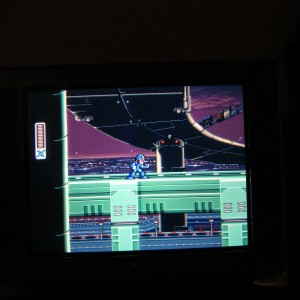

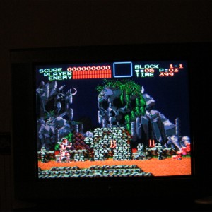

    A few more cam shots. Better cause I didn't handheld shoot and had some ambient lighting to balance things out.
    Super Castlevania IV I turned the TV to VIVID to show as much color as possible and a real test of small differences. On standard room would need to be black and then I'd have exposure problems.
    [​IMG] [​IMG] [​IMG]

    Turning on processing (vivid etc) is a bad idea. Its messing with the original brightness, colour, etc
