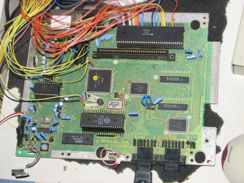

    This is the best way to do it: http://www.amazon.com/Hakko-Desoldering-Kit-With-808/dp/B000ARPULW
    I have one, one of the most useful pieces of kit I ever bought. Makes desoldering devices like this almost trivial. It's the only way you can do something like this:
    Without completely stuffing it up.

    Yes hakko (808) desoldering gun is the key. I recommend getting it from the us with a suitable step down transformer. Save yourself a couple of hundred bucks i shit you not! I got a quote from prime electronics, $500 for just the gun. I got the gun, stand, 2 different size tips, spare filters, different size cleanings rods etc and the step down transformer for $350 to my door.

    That Mega Drive board is very impressively done, I have to say! :congratulatory:
