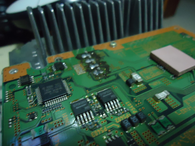

    Good evening, everyone.
    Last evening I disassembled my very first fat PlayStation 2, ever, and I wish I had known that what I have is highly unusual BEFORE putting the entire thing back together again. I picked it up in an as-is condition from a local thrift store in my area, and had only disassembled it to clean the fan exhaust.
    While looking at the board, I was impressed by its compact size and had started looking up other boards online out of pure curiousity. What I noticed is that every other board I had seen was far larger (longer), and looked to take up the entirety of the bottom of the case. Again, this was NOT what my board had looked like (and in case you're wondering, NO: there was nothing missing from the inside of the PS2, and it powers on & functions perfectly, save for the DVD drive not reading discs).
    My board is square, with a large heatsink.
    When I get an opportunity, I'll take it apart again and present some photos of what I have.
    In the meantime, however, does anyone out there have any clue as to what I have?
    PHOTOS (apologies for the blurriness of the photos, my phone camera focus no longer works!)
    Now, I double-checked the rest of the chassis, and outside of the DVD drive, expansion adapter interface and fan, there's nothing else in this PS2.
    Is this type of board normal?!

    You have an early console, that's all. Unless your main board has something different about it (unknown chip revisions and models etc), it is just another mass-produced retail console.

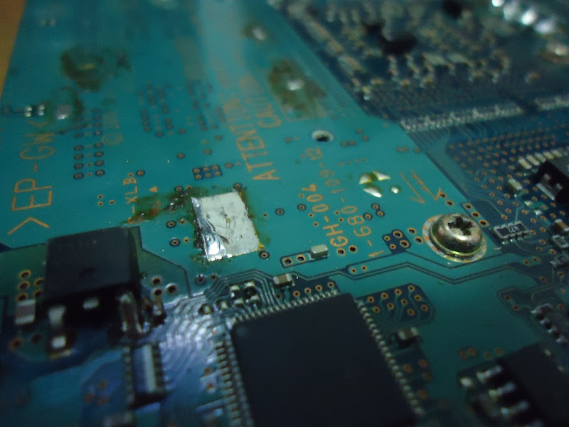

    That's a GH-004, ten screws U.S. Launch console.
    I have four of that type.
    That console is more complex than newer units and it has the "auto tilt motor" which pisses off noobs (the white parallax cog moves with an automatic adjust routine).
    Because people who think they know about the PS2 can't deal with that unit (mostly because the unit aways move the tilt adjust back to the original position) they think it is a bad console but it's actually one of the best Expansion Bay models that there is. The only flaw it has is that it only work properly with the KHS-400B laser.

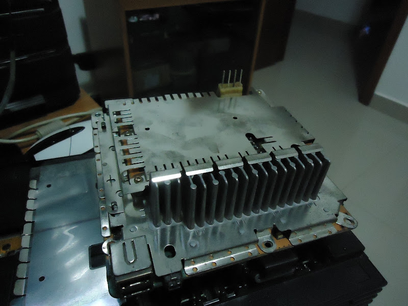

    Some pics of my own.
    That one had a modchip fitted at some point. I had the modchip removed when softmod got useful enough to allow for launching everything (even copied DVDR discs) but game CD-ROMs. Because modchips cause collateral damage I prefer to keep my systems vanilla.
